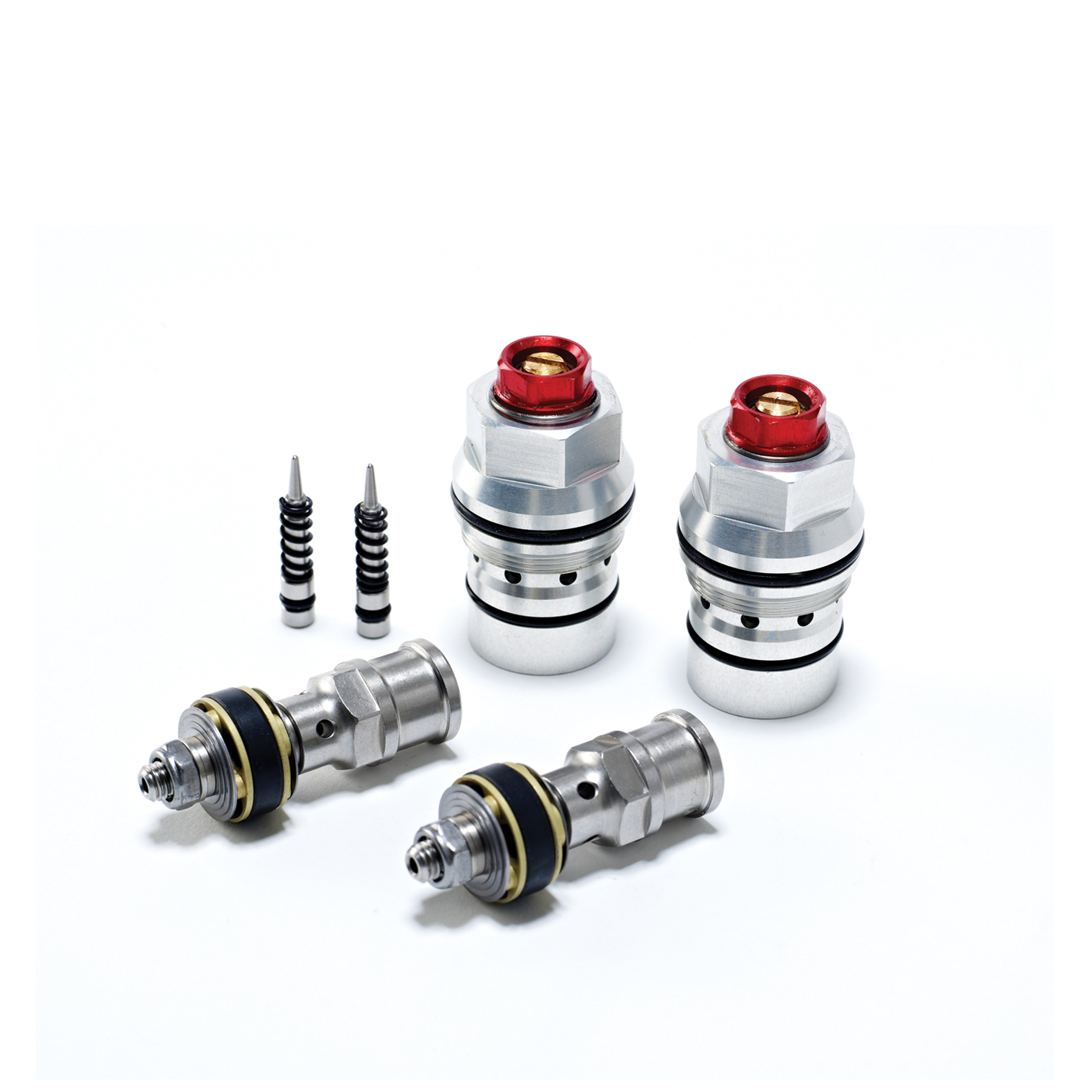

    Hi All,
    After 33k miles one fork oil seal has let go so a good service is needed, I investigated a few options and as I've always been curious about aftermarket suspension I thought I'd give the K-Tech SSK20 Piston kit a go.
    I contacted Brooks Suspension and after a chat with a polite and apparently knowledgeable chap, I opted to replace pistons, springs and compression adjusters. Apparently K-Tech insist on the installation service, as my forks are due to have a thorough overhall I'm content to have Brooks take care of the service.

    Thought it was worth resurecting this thread to round things off after my first ride, I spent the long winter sulking about the finely scratched stanschions, even spending a few hours attempting to ever so gently buff them out.
    I reviewed the Honda workshop base settings and compared them against the KTech internal kit with a mind to really spend some time dialling in the new setup. After rebuilding the bike and starting it in the garage last week to ensure I had some charge in the battery. I put my leathers on and pushed my bike up the drive to be dissapointed as there wasn't enough juice left in the 8 month old Yuasa YTX9-BS to start up again, despite being connected to my notoriously flakey Accumen which has let me down repeatedly, costing 2 new batteries in 2 years.
    One week and one new optomiser later and I managed to get some spare time to ride. My plan was for a 25 minute round trip so I could give them a tweak and repeat until I found something close to a decent setup. Creeping up my road I thought the bike felt different, was this due to my usual 4mm drop on the front to provide a slightly quicker turn in?
    About 80 miles later I returned home with that grin. I didn't realise the difference setting up suspension for your weight would make, it just feels right. I'm more relaxed, smoother and despite telling myself today would be all about slow and steady; just enough to get a feel for the bike again after the long lay off. I felt effortlessly quick, smooth and relaxed, fork travel appears to be ~10mm from bottom when I'm riding at 70%. Maybe 1 - 2 turns stiffer but that should be all.
    The only dissapointment is that I waited this long, with over 30 years riding experience I can't think of any bigger improvement for ~ £550.00.
