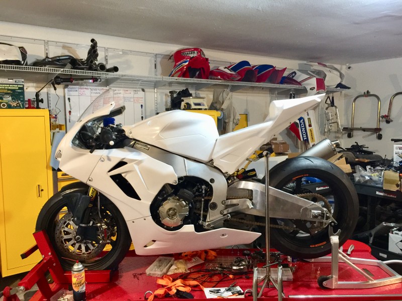

    Practical implementation of some of the ideas discussed, the current progress of my EWC build.
    Stock SP2 motor & frame, Katech suspension, Brembo GPRXs, DPMS swingarm, OZ Racing wheels, TKRP SuperStock flashed HRC ECU, HRC harness, HRC dash all wrapped in CleverWolf HRC Endurance skins.
