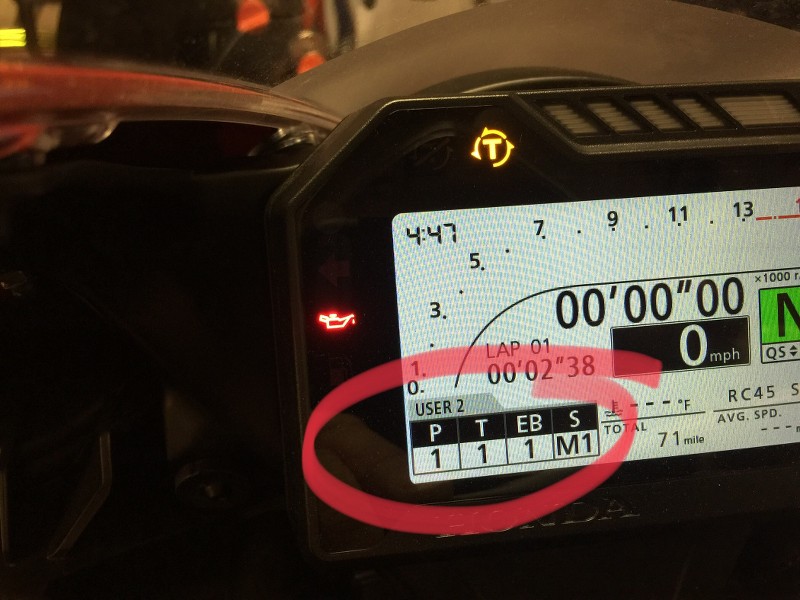

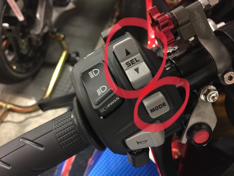

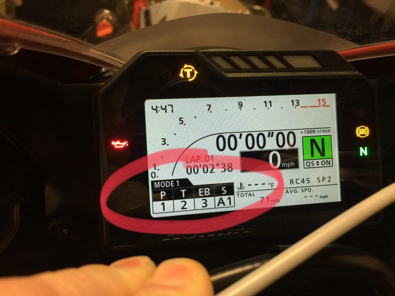

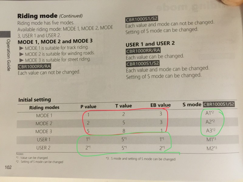

    Ok - I think there may be some confusion as to what you can and can't edit - and the use of the presets.
    In the 3 preset Modes 1,2 & 3, only the A1, A2 and A3 behaviour can be altered - not the actual values A1, A2 & A3.
    With regard to what shows up, In Mode 1 Suspension should be A1, in Mode 2 Suspension should be A2 and in Mode 3 Suspsension shoudl be A3.
    If not, then your dash board is malfunctioning.
    You cycle through the 5 Modes (1,2,3 User 1 & User 2) using the [^SELv] rocker button.

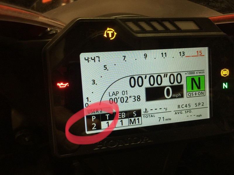

    You can change the values of P, T, EB & S in User Mode 1 & 2 by pushing and holding the [MODE] Button until the value is highlighted, then cycle through the available options using the [^SELv] rocker button.
    Press and hold the [Mode] to exit this User Mode edit feature.

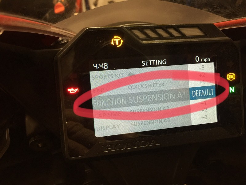

    To edit the behaviour of the A1, A2, A3, M1 and M2 Suspension presets, you need to enter the full setup menu by pressing and holding the [MODE] button and the [^SELv] rocker at the same time.
    Then navigate to the appropriate section of the Function Menu.

    Riding Mode 1 is track mode.
    Riding Mode 2 is back road mode
    Riding Mode 3 is freeway and in town mode
    Suspension Mode A1 is the semi-active Suspension mode of Riding Mode 1 which is suitable for track speeds and aggression.
    Suspension Mode A2 is the semi-active Suspension mode of Riding Mode 2 which is suitable for smooth back road speeds.
    Suspension Mode A3 is the semi-active Suspension mode of Riding Mode 3 which is suitable for mild motorway and in town speeds.
    You can further refine how semi-active modes A1, A2 and A3 control the suspensions response in Braking, Acceleration, Cornering and General situations.
