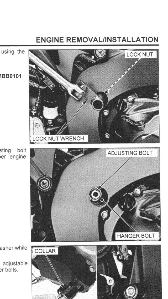

    Hi chaps
    I'm in need of a massive favour from you good people I am fitting a new engine to my 09 blade in a couple of weekends time and need to hire/borrow a locking nut wrench as in picture to remove the top frame nut and replace I am more than willing to pay for the loan and cover all postage costs this incurs looked on line to buy one and there bloody stupid money
    Many thanks in advance
    Brian

    you only need a castellated socket,i just made one from a socket I had.
    pretty sure you can buy them on ebay if you don't want to make one.
    assuming this is your first time droppin/fitting the engine on the blade,be very carefull loosening the allen head engine mount bolt,it goes through the frame+engine to the other side,but it also turns the engine spacer mount,which has 2 tabs on it that lock onto the engine bolt (you'll see what I mean when you get to it.anyway,the tabs are very easy to snap if the engine is under any load and then can be a real pain to loosen off.not expensive to buy,just a pain in the arse when you snap them.

    Oops sorry ma bad.......just seen I posted a link to the swing arm tool rather than engine tool. :oops:
    Just took a quick glance at the tool in the pic the same seller does sell the engine tool as well tho.
