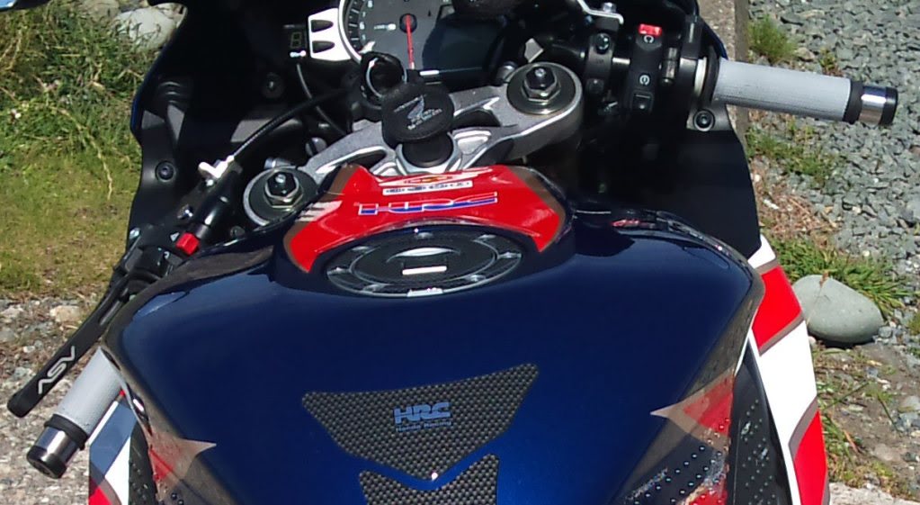

    I added Renthal dual compound road race grips and R&G bar end sliders today. Didnt quite get it right and might have to bin the grips and go again as I'm fussy!
    Basically, I put the clutch side grip on first and pushed it up against the light switch clamp. I used a bit of carb cleaner to help it slide on. This worked quite well as it appeared to melt the old glue a bit and make it tacky. The carb cleaner then evaporates and the grip is now rock solid.
    Problem is, I then fitted the bar end slider and it looks like the grip has gone on too far... or is that how it is supposed to look? The grips are the same length as the OEM ones and I havent moved anything on the bars. I tried to wriggle the grip back off the bar but like I say, it's solid!
    I then thought stuff it and fitted the throttle side. Same thing again except there's also a gap between the grip and the throttle clamp as there is a ridge for the OEM grip to grab onto. (ie. there's a groove in the OEM grip that fits over the throttle tube ridge).
    Anyone else fitted grips and r&g bar end sliders that have managed a better job than me???? (told you I was fussy!!!)

    I carefully tapped the locking thread nut wotsit that sits inside the bar in a bit with a brass drift and the bar end weights go where they are supposed to now. :)

    Yes mate... take them off, then you can tap the locking nut in a bit. There's a little stopper to prevent them from dissappearing inside the bar but you can gently tap them in a bit so that this passes the end of the bar and they still work the same. Basically make a note of how much further you would like them to go and tap the nut in by that amount. One side stuck out more than the other on mine.
