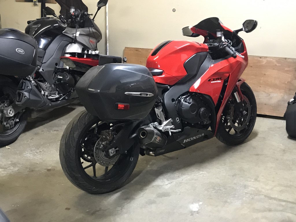

    In search of a bike that was somewhat lighter than my FJR, I settled on a 2015 CBR. I knew before I bought it that nobody made a hard bag mount for this bike but I also knew that I could make my own. I haven't finished the project yet but got far enough today to share a couple of pics. When I'm done, if there is any interest, I will find a place to post more pics of making the mount along with my detailed drawings with dimensions so you can make your own. Also the CAD drawings so you can have your local shop cut the main mount if you want to spend a bit of money. The main piece is 3/16" aluminum (5052 alloy).
    Anyway, here's where I'm at ( just one bag mounted at this time ).

    Impressive @David M and hats off to your engineering skills - not something I will rush to do for my blade, but if this fits your needs, go for it. Also like the fact that you are willing to share the design and fitting details for others who are interested.

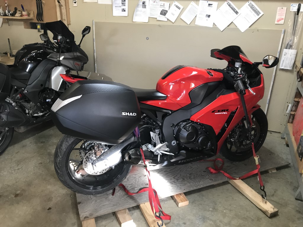

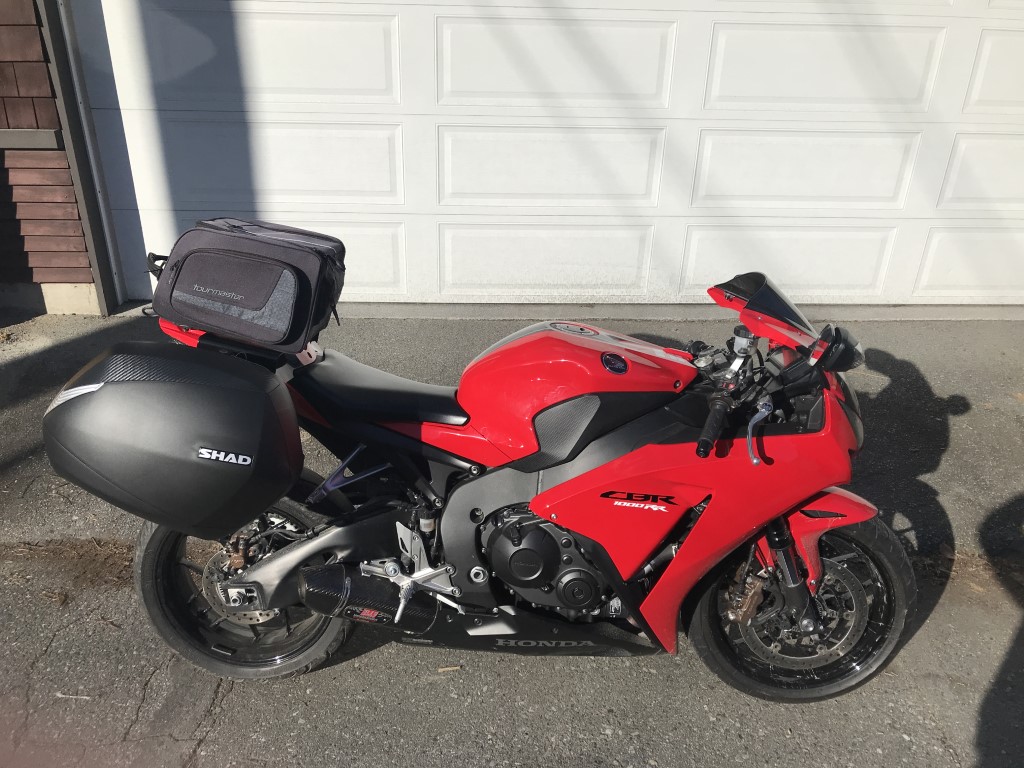

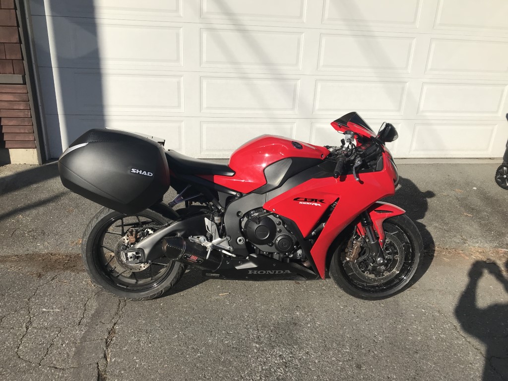

    I did a bit of a left turn on the hard bag installation. I returned the Shad 36 bags and made adapters to mount the bags from my FJR. Smaller, better quality, and I have the inner liners for the FJR bags that I've used for the past 350,000 Km's. And, the bike is 6 inches narrower vs the Shad bags. The colour doesn't match but it's close enough.
