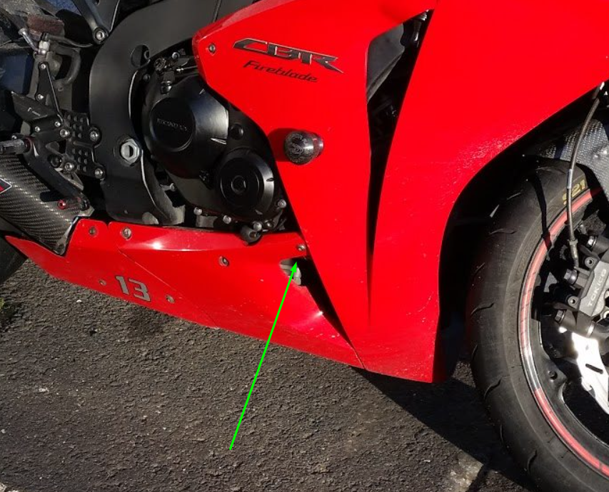

    Yes it was indeed me...... I ended up snapping one of the locating lugs off the belly pan where it attaches to the lower part of the fairing so drilled straight through both sections and put a push pin in to secure. I did the same on the other side just for extra strength and so it looked the same.
    I had ordered a packet of push pins so I had them ready for when I did the Chinese fairings change over just in case I needed some spares. Can't remember what size they were but if you do a search on ebay (honda cbr 1000 rr push pins) something with crop up. Just match the drill size up to the main body of the push pin and jobs a good'en!
    I'll try and find a picture of it;)

    You can just about make it out in this shot....... Screenshot_20200415_065456.jpg

    I did the same thing, used the push rivets as used in the inner black trim near the clip-ons.
    holes size is 6mm

    It was a 09, drilled it in the same place as PauloHrc. You just need to make sure you have enough material around the hole (especially the belly pan) to provide enough strength to avoid cracking.

    A push pin will work fine for holding it together. I drilled the fairings while they were on the bike, just don't drill with too much pressure so you don't pop through the other side and hit anything metal but even if you did you're not going to do any serious damage. Didn't have any problems with cracking, just don't drill too slow as it could catch/snag. A good confident drill straight in and straight out is whats required ;):D
