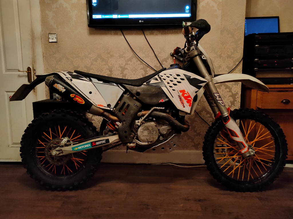

    New is perhaps the wrong word. The bike's nigh-on 12 years old and it's been in the garden for nearly two now. I'd already ridden it on the road, on the beach, on the track....
    ...but cash changed hands and it's now part of my stable rather than my flatmate's. Happy days. :)
    So it's an '09 KTM EXC 400.

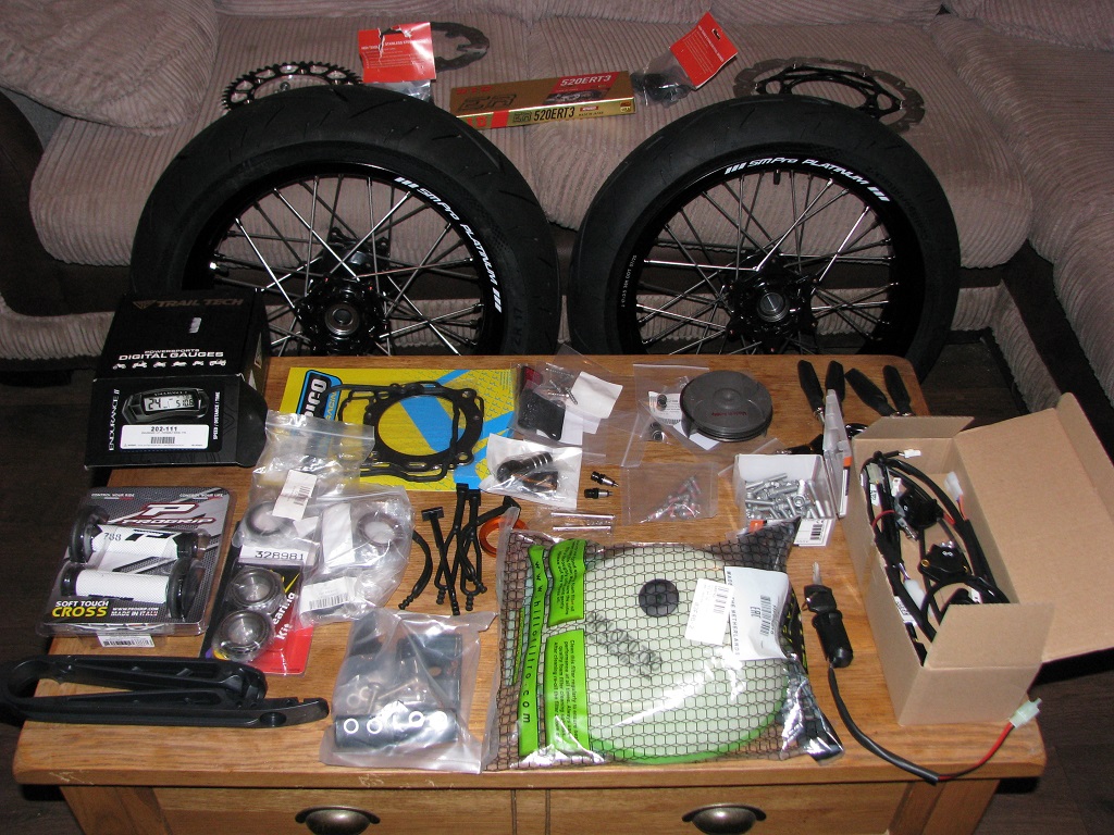

    On the little to-do list are wheel and head bearings, air and oil filters, chain and sprockets, greasing bolts and painting the frame and other steelwork.
    The bigger list came about due to the pandemic. The tracks are all shut and so is Drumclog. In the meantime I figured the best way to get some use out of it is to put in on the road, hence:
    17" wheels, tyres, 320mm disc up front, Speedo, indicators, seat cover, grips, more new sprockets, mirrors, ignition switch...
    ...and then there's the "while I'm in there" list. Fresh piston, maybe clutch plates, valve stem oil seals...
    ...and the phase 2 list - basically a wish list for the future. Seat concepts saddle, Baja headlight, SM style mudguard, beefy front caliper, fork and shock lowering kits....

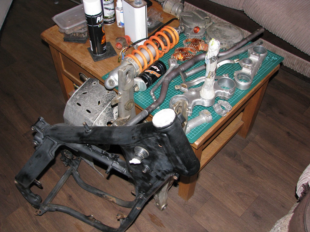

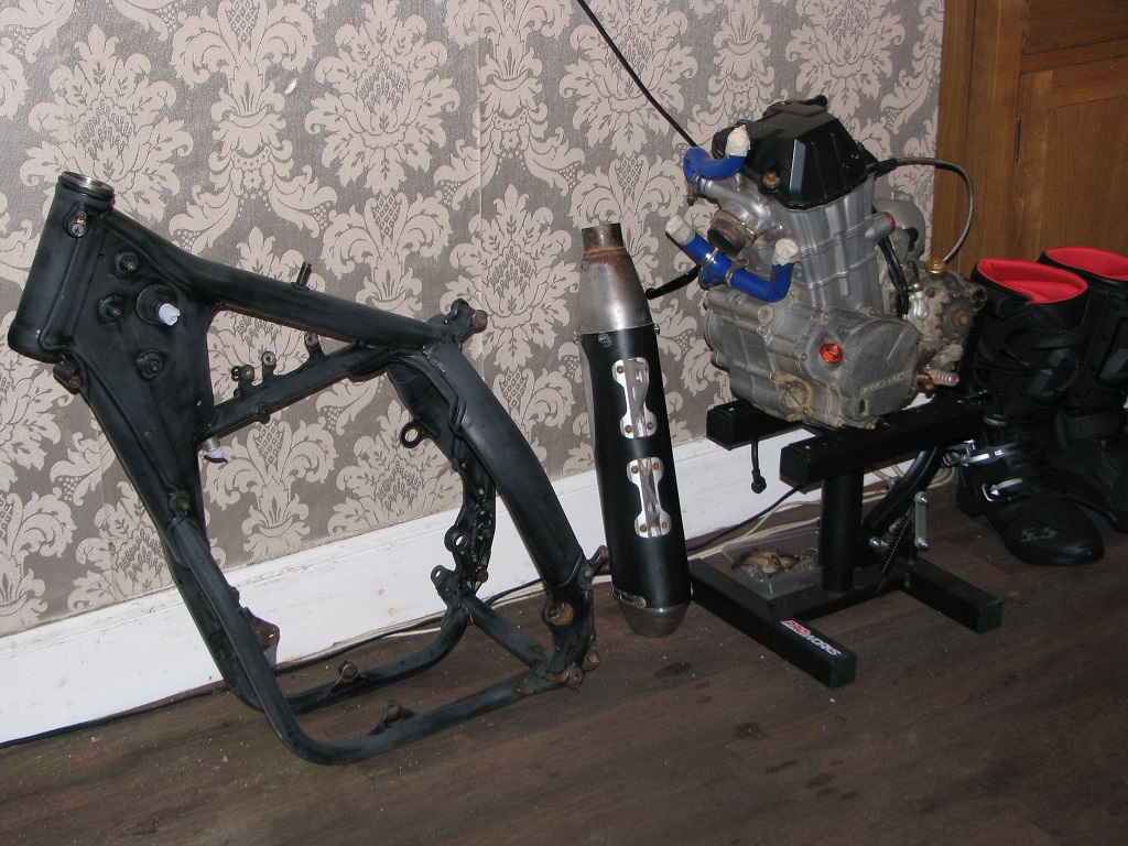

    The current state of affairs:
    Cleaning the engine prior to cracking it open. Prepping the frame for painting.

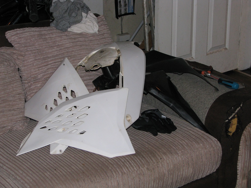

    Just finished hauling the transfers off the bodywork. Fancy a plainer look - something along these lines.

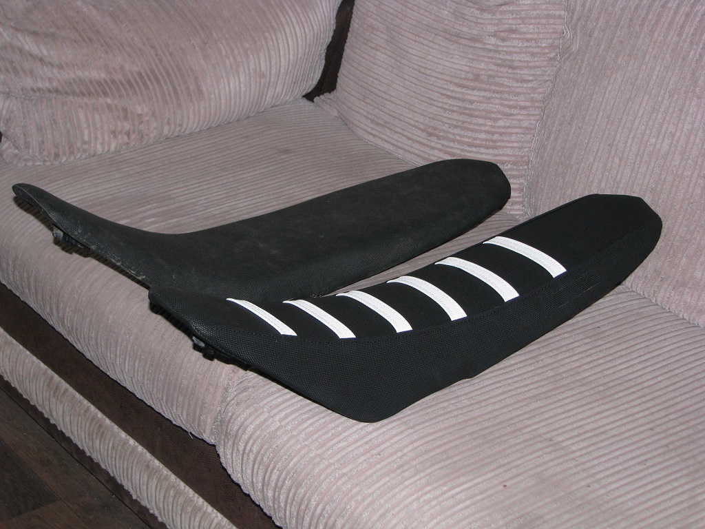

    Seat that was on it had been lowered. Picked up a scrappy ebay replacement that had all it's foam and put a fresh cover on it.
    Spare base can be used in phase 2 for the comfy seat.

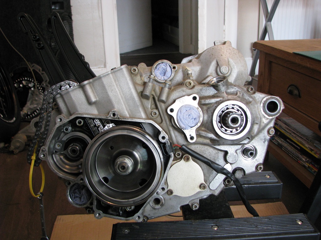

    Did cross a little landmark moment last night. Hit the point where all the shafts are passing the wiggle test and am in to the last of the consumables - from now on it's reassembly. :D
    Everything was gubbed but only just. Two of the clutch plates were under but the rest were still just in spec. The springs are bang-on the lower length. The piston's little teflon pads are practically gone but there wasn't much wear on the skirt itself(and the barrel looks good).
    So yeah - just catching everything at the right time. :)

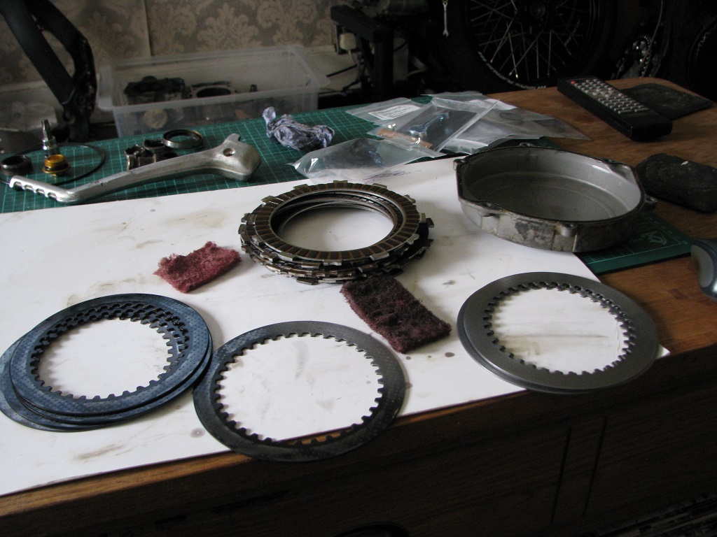

    Very next job was pulling the external seals. The gearshaft was leaking, the kickstart weeping and I thought "...what the hell" and howked the driveshaft seal as well.
    Bit of boring, time-consuming cleaning of the metal plates. Still waiting on the new friction set.

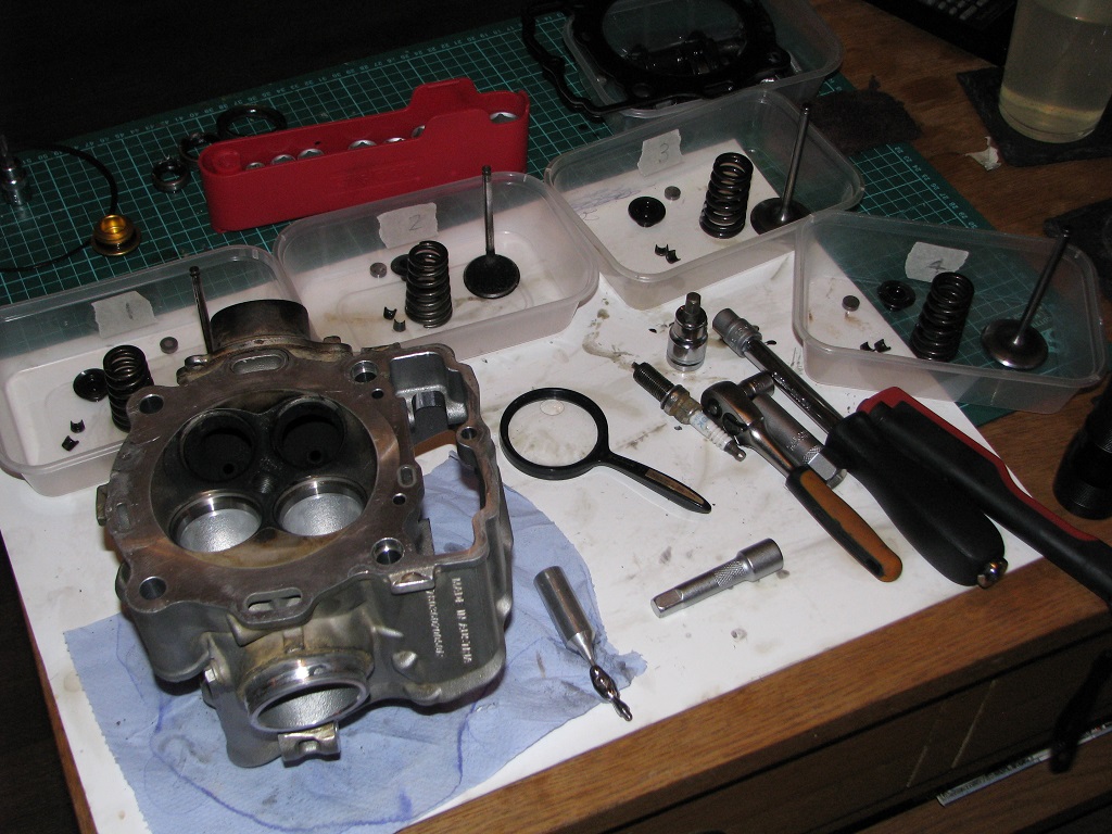

    Initial compression test a while ago wasn't great. Seen worse - seen better. Alcohol pool test showed it was mainly the exhaust ports that were seeping.
    Turned out to be light carbon build-up. I'll give them a quick lap once they're clean but it'll just be for the sake of it - really a good clean is all they need.
    Inlets are in lovely condition. :)
    ...which is funky because they're the titanium ones that can't be lapped anyway.

    Faffing around with the bouncy bits still seems a-way down the road to be honest. Tonight's little game was ordering shims, which meant measuring the old ones and looking at them for the first time.
    ...and y'know, I'm not sure that the clearances have ever been changed on this lump.:eek:
    For a start the gaps were a f'kin gazillion miles out. (the inside cluster of numbers are the measured gaps)
    They're also all the same brand of shim - the construction is quite distinctive and while the numbers are well obliterated the edges of the engraving can still be seen and their style matches too.
    Another clue is that they measure to 0.01 sizes.
    Numbers in boxes are the new shim sizes and sideways numbers in boxes are expected clearances.
    Scribbled-out numbers are where I fell for the once-a-decade gigglefest that is the half-mill thread on micrometers. Oh what fun it would have been to order a full set of shims ten sizes too thick.
    Better glasses or a digital micrometer might be on the cards. ;)
    Still - good on it all for holding up! :cool: At least I know that the clearances increase(the safe way) and as it's worked out the exhaust shims I'm buying now will cycle into the inlets in time. I've also ordered the 2.95 that the RHS inlet will be looking for soon.
