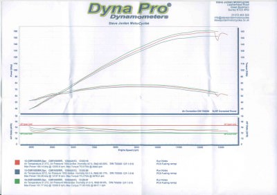

    The bike was also dyno'd after I fitted the Akra, K&N and PCV
    I'd loaded the Dynojet map to match the pipe, but could feel it over fueling on lower revs and hanging onto revs after I'd closed the throttle - almost as if it had a choke left on, but at 4k-5k upwards it felt fine.
    After the remap it was spot on. It now feels as good as the stock bike did, but with a little more crisp throttle response and it's smoothed out the lump of torque at 3k that caused me a couple of surprise wheelspins in the past
    Over the free map from dynojet, the lower revs are leaned out, but the mid + top end are pretty close to what dynojet provided.
    I'm happy to share the map (below) if anyone wants to use it (note: You do so at your own risk)
    Here's the dynosheet to see how it ran.
    The dark blue is the zero map - the stock Fireblade fueling
    The red line is the DynoJet map that I'd loaded to match the Akra (M16-002-011.pvm)
    The green line is the new custom map
    Overall - a very happy bunny and the staff at Steve Jordan's were fantastic too which was the icing on the cake

    No worries. The link to the map is in the 1st post (it's a clicky link) :)
    If you don't already know, you need to download the DynoJet software (free) from their website to load it into the PCV and it's really quick to do.

    P.S. I suspect you were using a US map from the DJ website (M16-002-011) - US fuel is different to ours. EU maps, the last 3 digits start with a 5. 16-002-505 or 16-002-515 probably would have worked better.

    Very possible. I'm sure I got it off the UK website, but it was just to get me by until I got the custom map. It felt fine tbh, but under 4k I could feel it 'hunting' slightly and could smell it was rich at standstill.
    When it was mapped they said the same - it was pretty close from 4k+, but most of their fettling was to iron out the lower powerband.
