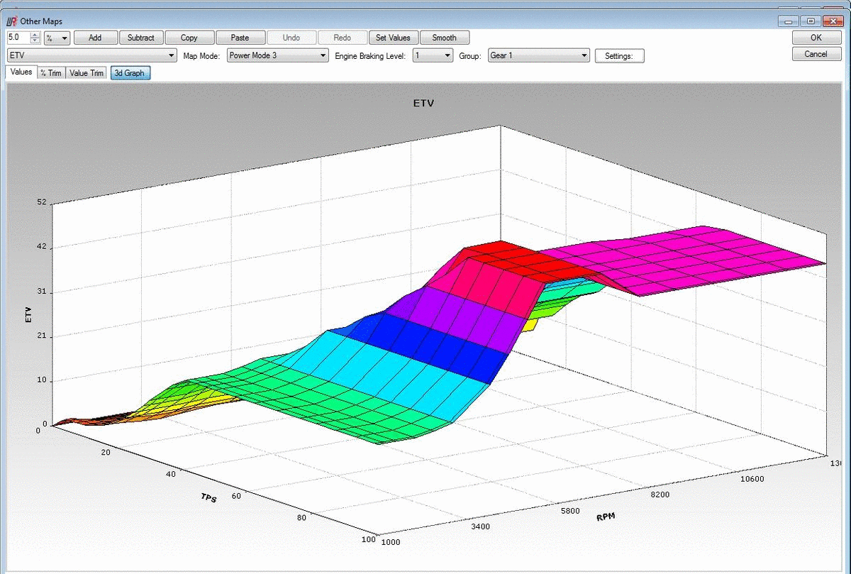

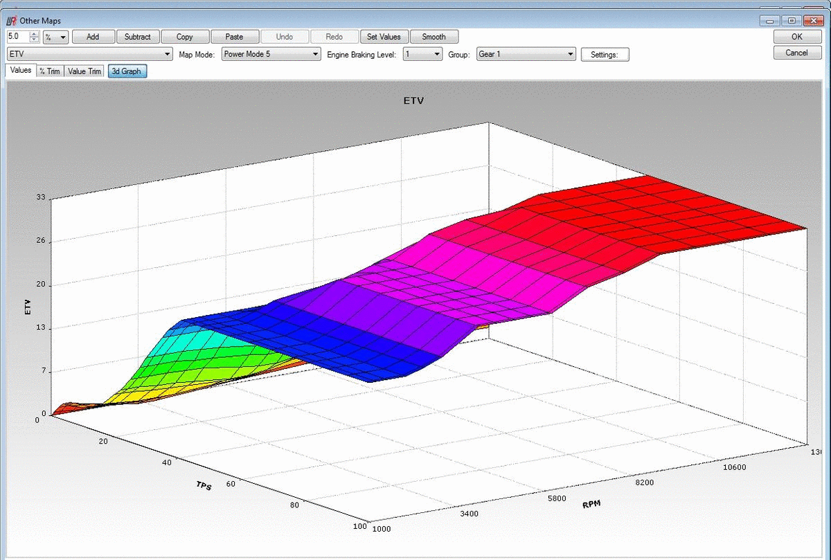

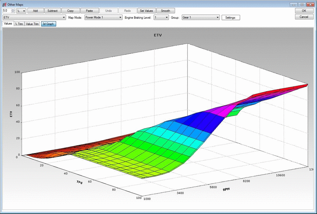

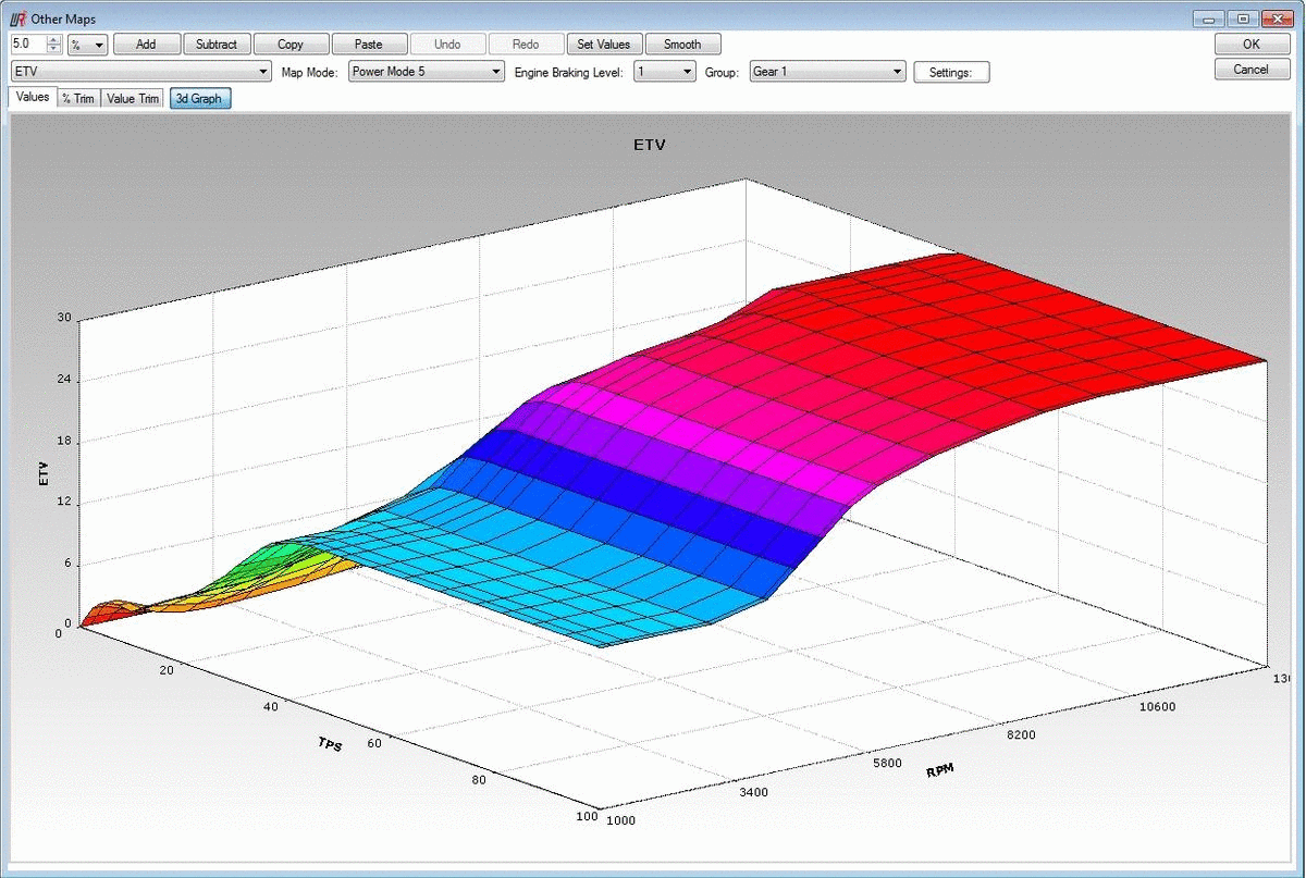

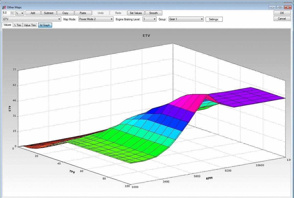

    The reason P1 feels snatchy, is you are dealing with full power in the higher rev ranges and the Fly By Wire is delivering a sharp relatively instantaneous 1:1 of your throttle input. Fly By Wire has no free play - it is direct.
    Visualization of the power modes, which are achieved through controlling the throttle body blades ETV independently of your throttle grip position TPS at various RPMs
    Note throttle position vs throttle body blade position vs RPM - and even see how some gears have a throttle blade cap ETV less than 100$ all the way to red line.
    Power Mode 5 is actually heavily limited in Gear 1 through 4, with only 5 and 6 having full power on tap.
    Basemodel, ABS & SP1 Power Modes - each animation is Gear 1 through 6.
    Power Mode 1
    Power Mode 2
    Power Mode 3
    Power Mode 4
    Power Mode 5

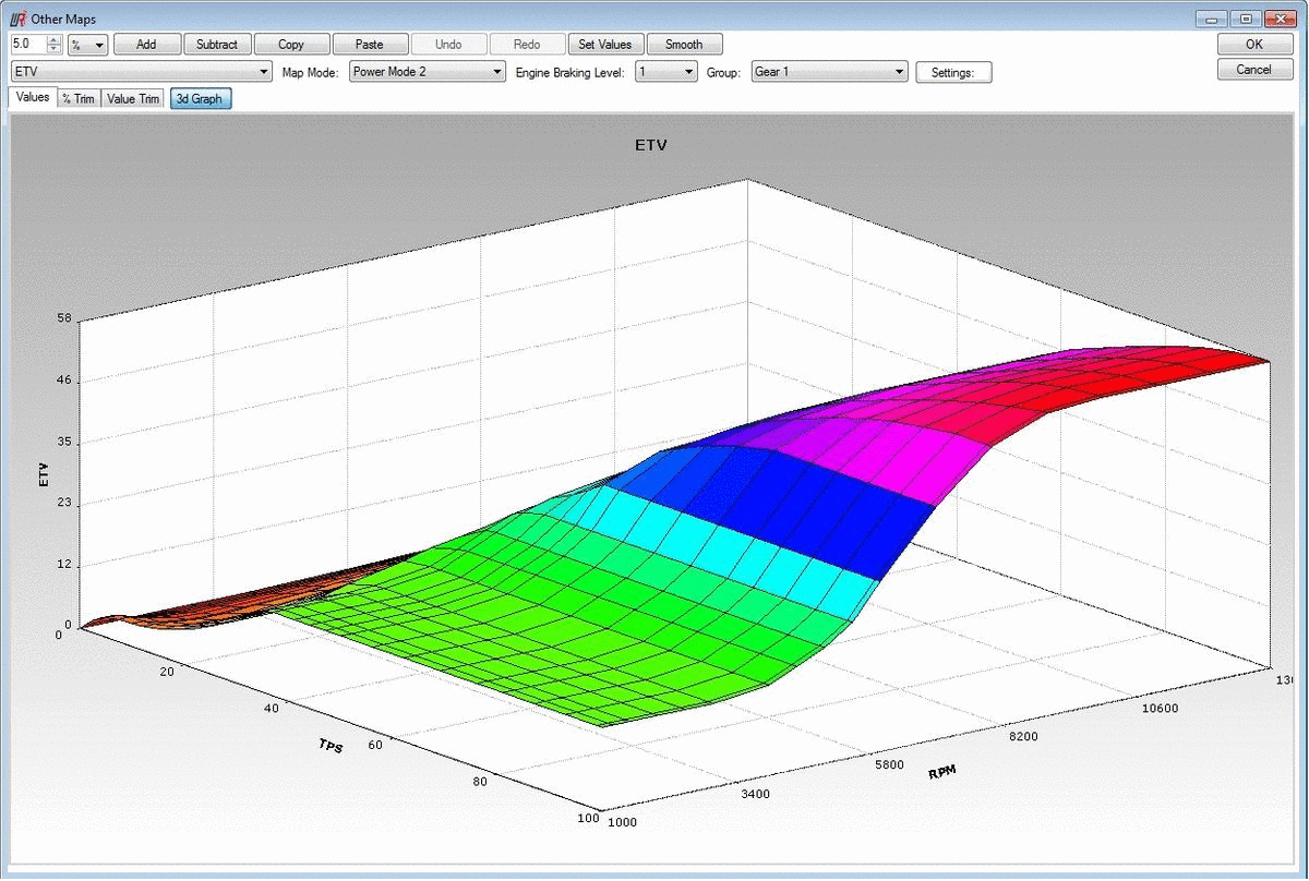

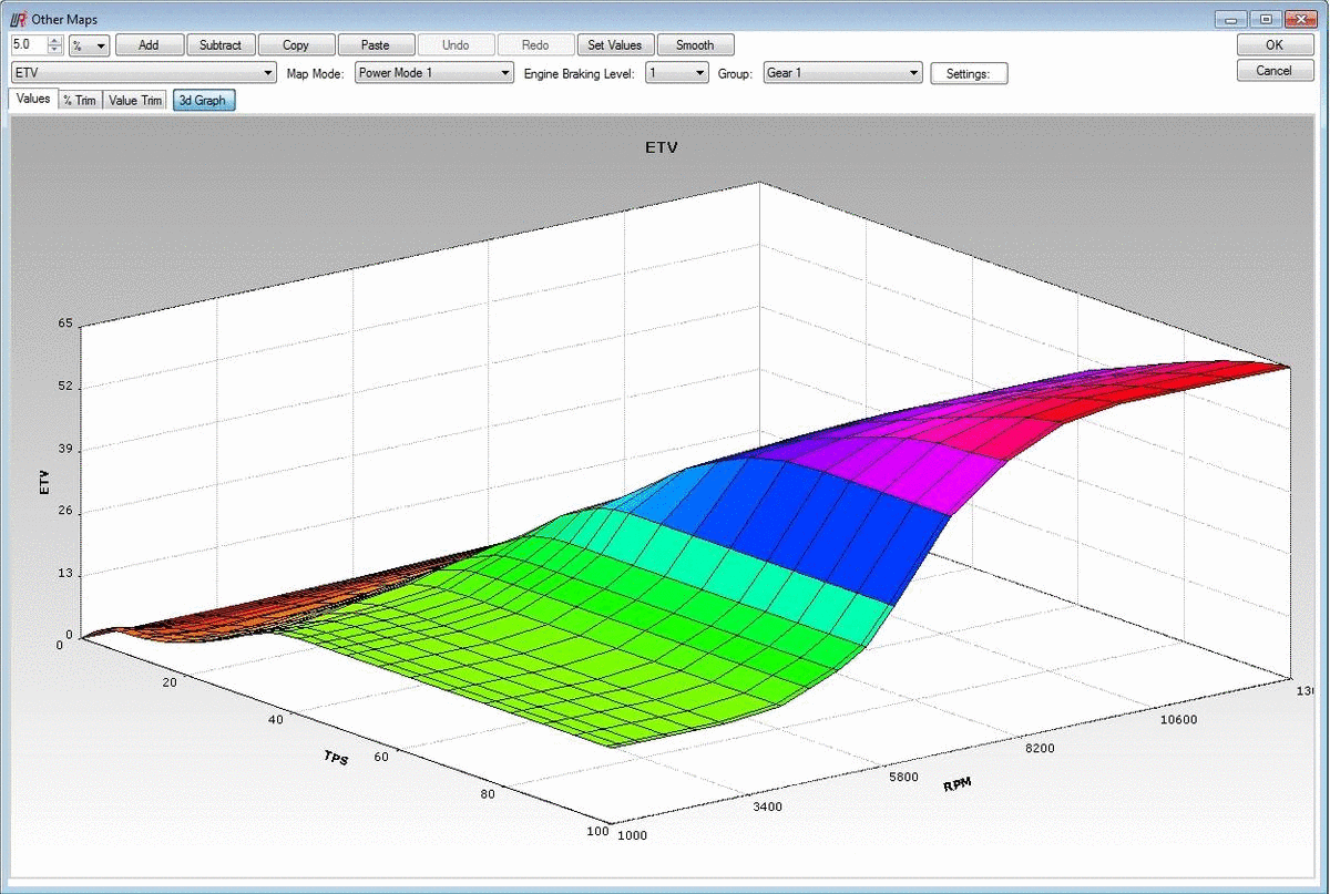

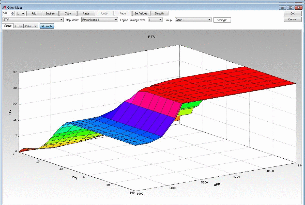

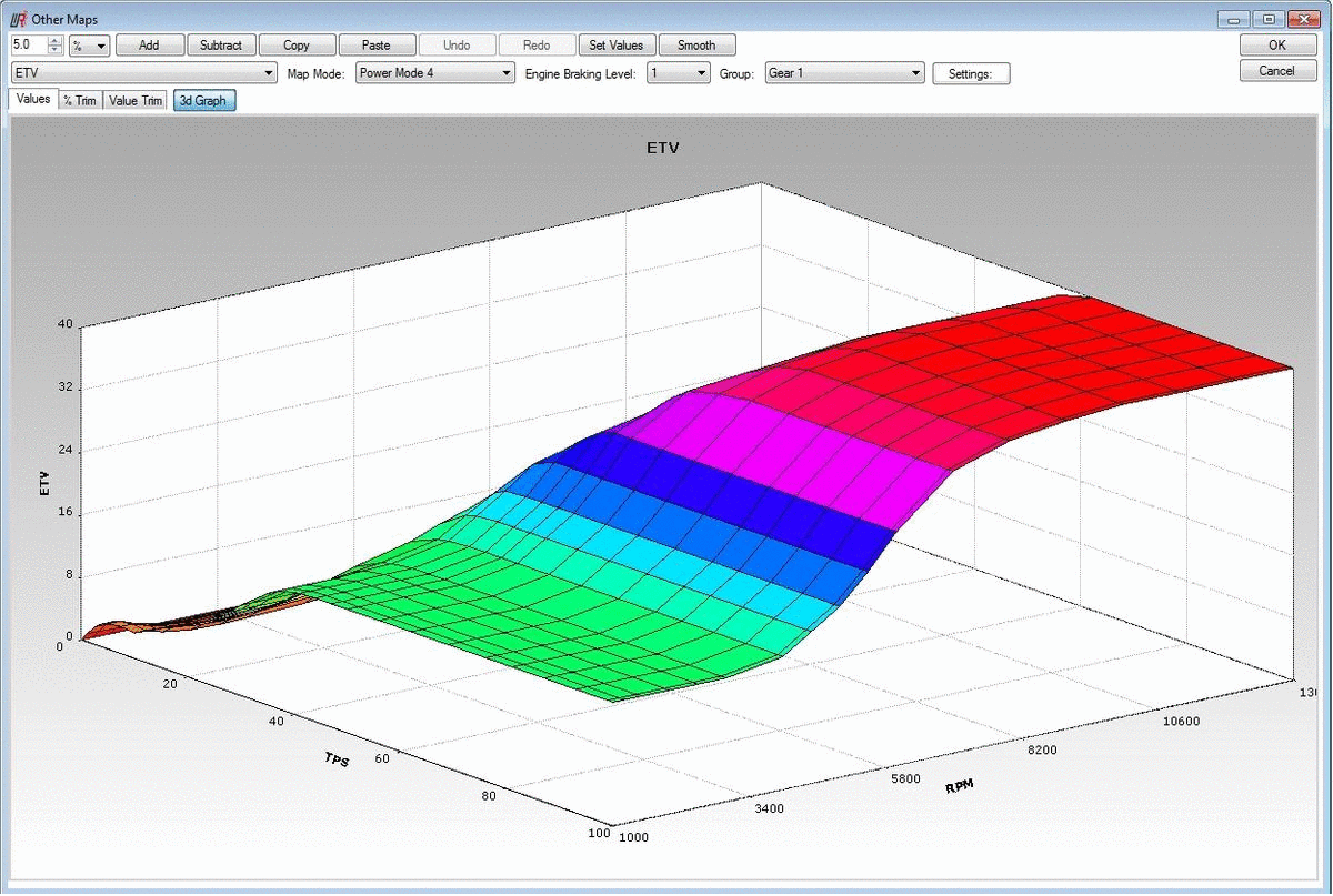

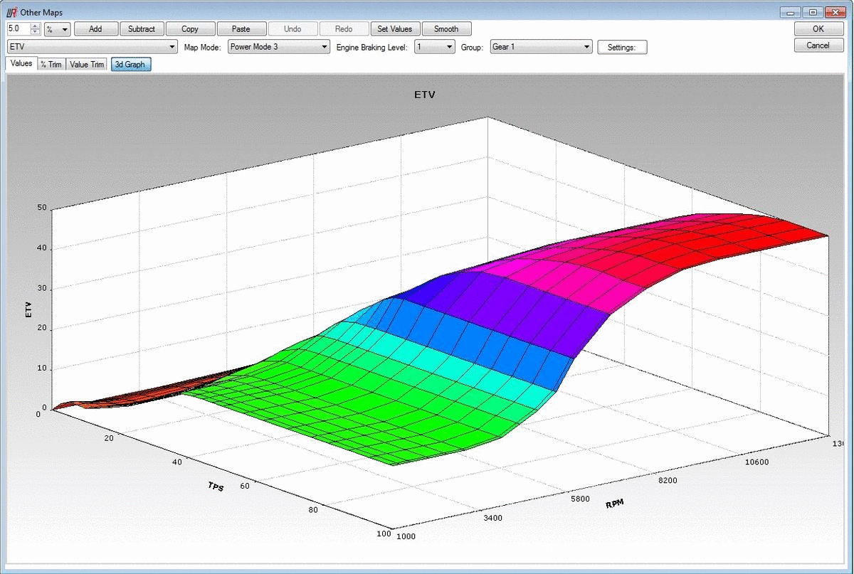

    And the even more discrete SP2 power modes.
    For the SP2 you will see that P4 & 5 are actually intended to be pukka damp and rain modes with a much smoother and gentler ramp up in power deliver at full throttle - and the P2 though P5 also have a feathered power delivery in the mid range to facilitate a smoother power ramp up out of lower rpm corners.
    SP2 Power Modes - each animation is Gear 1 through 6.
    Power Mode 1
    Power Mode 2
    Power Mode 3
    Power Mode 4
    Power Mode 5

    Great supply of information, @RC45 .
    I just wish I had the ability to understand it.:( The basic 'dyno' charts I'm fine with, but with these what appear to be millisecond by millisecond info just stump me.
    Anyone else the same, or am I dumber than I thought?:rolleyes:
  7. Stuish
    Stuish Senior Member
    Jun 17, 2018
    859
    395
    It looks to be showing the Electronic Throttle Valve (ETV) positioning, at different Throttle positions, in different power modes.
    Each jump of the gif is a new gear, from 1-6.
    I didn't think it was as restrictive as they were, some really interesting graph readouts.

    Great info tks RC45. I wasn't aware the SP2 was running different maps to the SP1 or stock blade - I suppose different valve size and cylinder head configuration would dictate. Please share the info source. I'd be interested to look at the fulling maps or F:ARs vs ETV-RPM/gear for the Euro setups

    These are from Euro/UK ECUs.
    Source is screen shots from each map in 3D view for each stock ECU loaded into Woolich software.

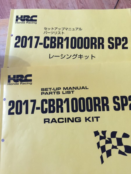

    Honda published SP2 power numbers in 2017. Same as base model/SP - 189bhp.
    When I got the service manual in 2017 it was easy to see how they achieved this. The SP2 stock cams are milder than the base/SP cams. In fact the base/SP cams are very similar to the $2500 each HRC cams.
    And the SP2 HRC cam specs where published and in the HRC setup manul from January 2017 - so any act that Honda UK put on "looking and researching" was just that an act - Honda UK are literally as clueless as the rest of us - which is why the Honda UK Racing guys had to work with Ten Kate and Honda Europe all the time.
    Honda Japan/HRC always keeps everyone in the dark - its like a game they like to play.
    This is how early SP2s where "race kitted" before the HRC parts became available - many race SP2s ran stock base/SP cams and the power bumps from 189 to close to 200. To this day many privateer SP2 race bikes still run stock base/SP cams or Cosworth grinds that are similar spec :)
    The bottom line is Honda are jerks and the entire SC77 program is a cluster. The SP2 is sold as a street bike that is never going to be supported on track by Honda as well as the Yamaha, Kawasaki, BMW, Ducatis, Aprilia and Suzuki superbike contenders are.

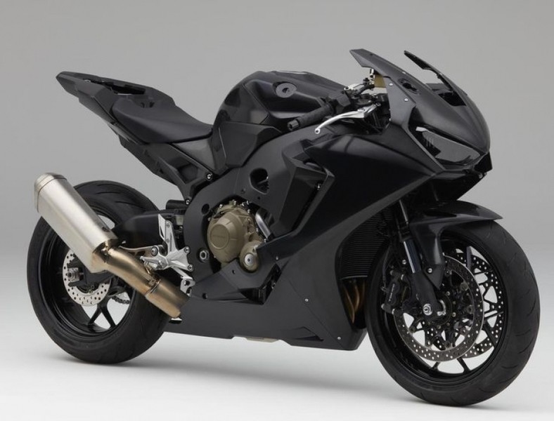

    The HRC kit was intended to be used with the SP2 Race Base bike HRC was selling. This is why Honda always said "The SP2 will only be for race teams". What they really meant was "the only way we can sell 500 copies of this cylinder head to the general public is by packaging it with non-race worthy parts that race teams will toss out and raising the price and calling it Limited Edition SP2 - then for everyone else that wants to race they can buy the Race Base - but we wont bother tellign anyone about the Race Base until AFTER the street sucker SP2 goes on sale".
    SP2 Race Base - not brakes, suspension, wheels - all base model components
