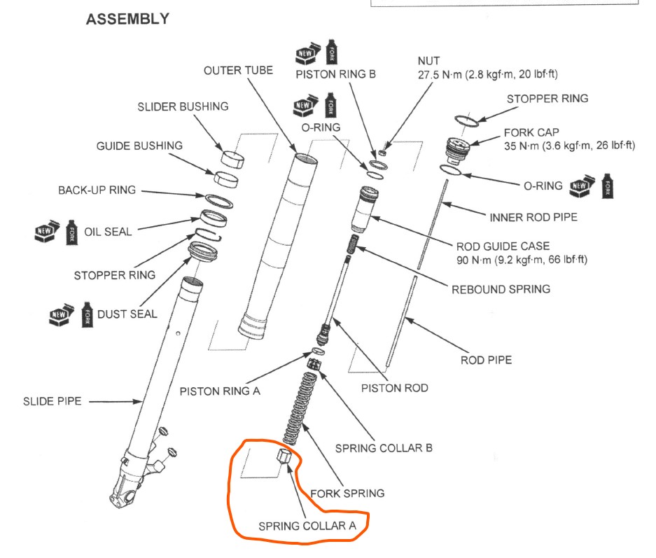

    I'm working on a fork oil change on my 2012 with Showa BPF forks. Unfortunately the previous owner put the plastic collar in upside down and it is now stuck. It is the collar the icedmind's thread (https://www.1000rr.co.uk/threads/sh...-suspension-setup-for-road.39524/#post-532288) specifically says not to put in wrong because it will get stuck.
    Part I'm talking about:
    Has anyone had luck getting this collar out after it was installed incorrectly? I've tried hitting the bottom of the fork, but it won't come out. Has anyone found a way to get this out or should I just forget about it and throw it back together?
    Thanks!

    I certainly agree. The only reason I'm considering putting it back together is that the fork was assembled incorrectly since I purchased it back in 2017. Never really noticed an issue but did get some odd wear on the front tire.
    I'd love to get it out of there so I can do it the correct way, but I'm out of ideas. Hopefully someone has seen this before and came up with a solution.
