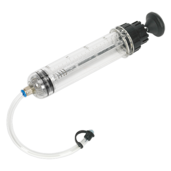

    Anyone done this before? I've fitted an Accossato MC to the bike and HEL lines so the system is totally dry. I've got one of these syringes that I was going to use.
    What's the process? Does the brake lever need to be pulled in when filling?
    Are there other methods that are better? I did my old blade with a Mityvac and it was a PIA so I just ended up bleeding conventionally.

    Well it all worked pretty well. Put the fluid in the MC and used the syringe to pull the fluid down to the calipers and out of the bleed nipple on the MC. Then just bled the whole thing using the traditional method. Didn't take very long to get a solid lever.

    Just FYI that Sealey VS404 syringe is brilliant. Figured since I was arsing around with brake fluid I'd change the stuff out of the back brake too. The syringe is large enough to use one-handed and seals well over the nipple so you can pull back to create the suction and then just crack open the bleed nipple. No air came through. Just fluid. You can just top up the reservoir and watch the fluid go down. Took about 5 minutes to swap the fluid out. No hassle whatsoever.

    Also, my rear brake was previously pretty useless. After swapping the fluid out it's back to spot-on. And that only took 5 minutes with the Sealey syringe.
