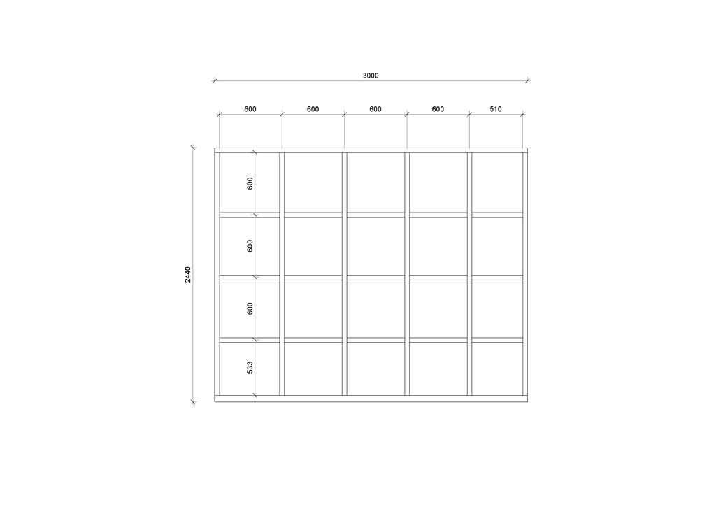

    Well I have created some plans in Revit. Going to go for a timber base as I think it will be easier to construct on my own. Its treated timber 45 x 90mm for the floor joists at 600mm centres with supporting dwangs to give it extra strength. The floor will be 18mm sheet Plywood.

    That will be strong, especially considering the use of 'Abba' or similar stand taking the full weight across its base.
    I have a builder-installed DIY shed with a very sub-standard base for bikes. (OK for lawnmowers and the like). Only this week I laid 15 mm ply over the top of existing floor and it is now very sturdy. On that basis, your '600 centres' with 18 mm ply will work well.

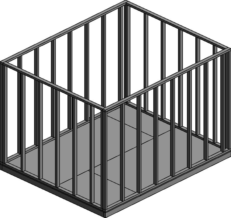

    Would you need some 'noggins' in between those uprights? :oops:

    431
    Yeah thats just the basic studwork. I need to work out where the window and door is going to be and frame them to suit. Also plan to have a 550m worktop along the length of one wall so that will need some noggins installed to support that.

    Gable end wall studwork setting out with doorway opening.
    Wondering if I should go with a double top plate?
