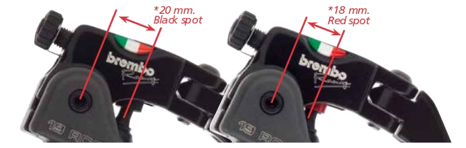

    The RCS adjuster changes the distance from the lever pivot bolt to the plunger, like so:
    The 18mm setting takes less force and more lever travel - the 20mm setting more force and less travel...
    ...to achieve the same same system pressure.
    Reduced lever travel with the RCS mainly comes from the increase in piston diameter from 17.5mm(OEM m/c) to 19mm. The adjuster is more for fine-tuning.

    The cylinder itself stays where it is, it's the hole on the lever(where you've been putting your spacers) that you move by turning a footery little screw hidden inside the lever body.
