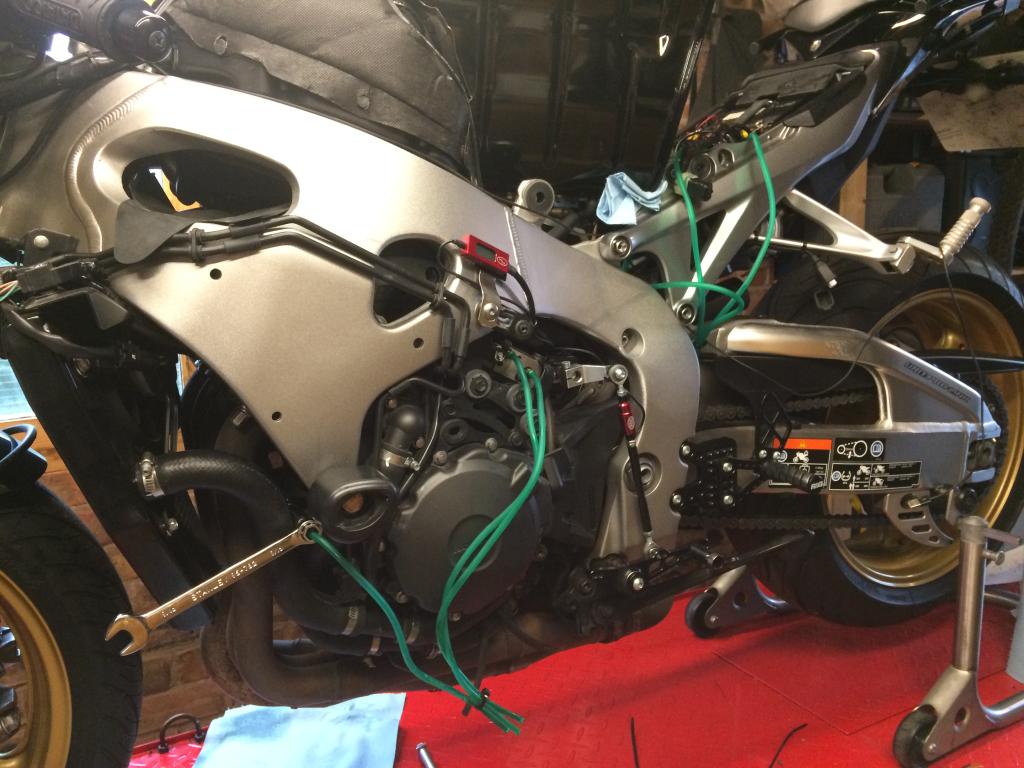

    Having followed Swiss T's guide for bleeding the C-ABS blade, I'm very grateful to him for preparing the original guide. I had my first run yesterday since completing the fluid change & bleed, and can confirm the brakes are outstanding now. The bike will 'squirm & wiggle' under very heavy braking doing it's electronic thing.
    The worst part of it all appears to be the non-repeatability of it all, ie some bikes are good, some not, some riders like it, others not, and obviously maintenence.
    I think the fluid change should be completed more frequently for ABS models, so if the new guide make provision for this all the better.

    Credit where credit is due.....fair play to you for this....my bike is like a new machine and brakes when you want it to. Thanks very much Swiss t, you are the man;)

    amazing how to
    having a 2015 blade
    the abs system i am having called eC-ABS
    is this how to for all abs regardless eC-ABS OR C-ABS `
    dealer quoting over 350 for abs bleed
    you should manufacture that toll of yours
    i will buy one :)))

    I'm not totally sure Taz, but I think the procedure differs a little in the latest gen.
    I no longer have a Blade but I'm glad people are making use of it; the official manual got a bit complex.
