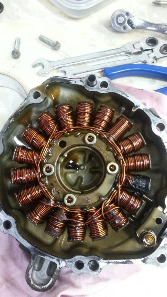

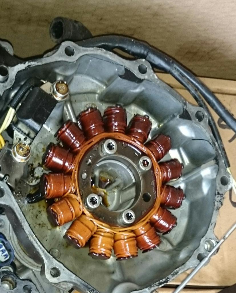

    Couple of pics
    CB1000r at about 35,000 miles I think
    80,000 mile old 2008 CBR1000rr stator
