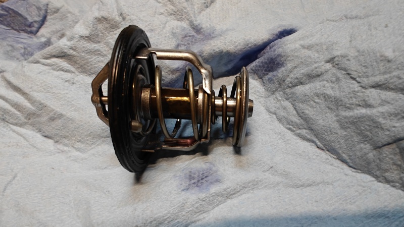

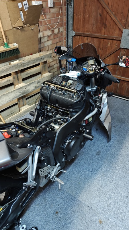

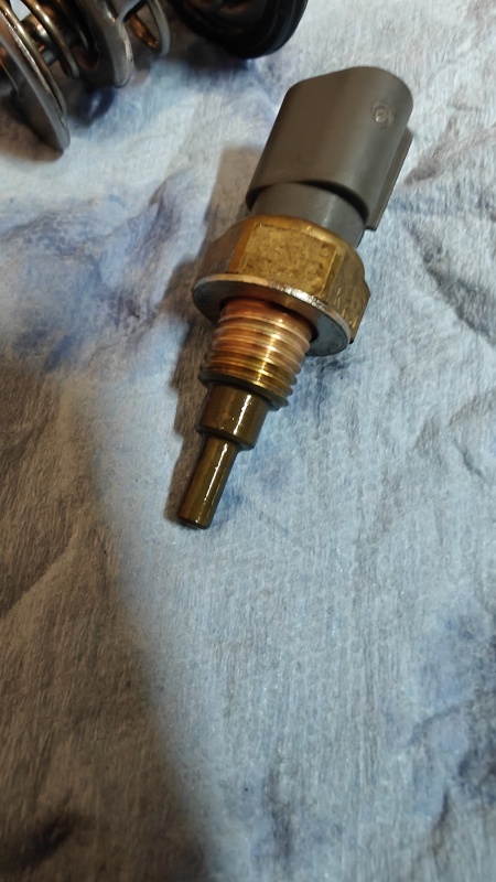

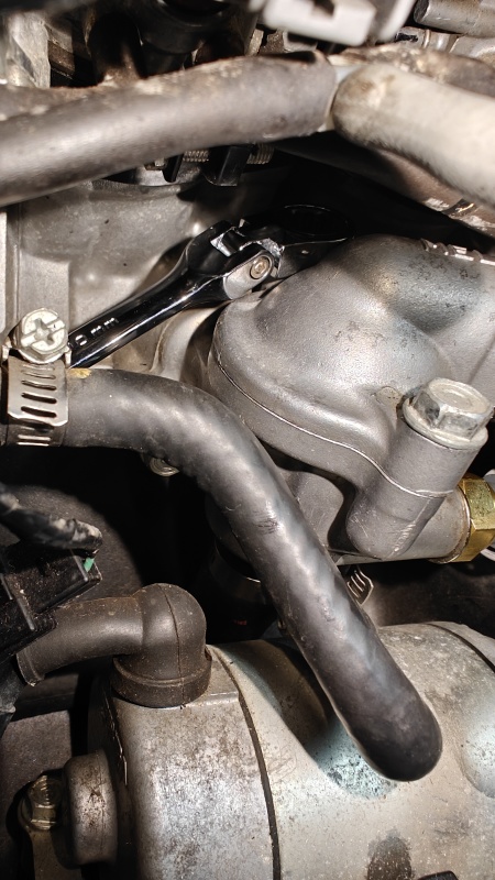

  15. BeelzebubUK
    BeelzebubUK Member
    Mar 2, 2024
    76
    114
    Managed to change them both this evening. Will refill and test tomorrow. So happy I bought some flex-head ratchet spanners the other week. Was able to get to the bolt under the fuel rails/airbox with a few mm of turn :D
    Both just looked tarnished but ok. Hopefully it fixes it.

  16. Boothman
    Boothman Elite Member
    Aug 15, 2018
    3,152
    1,501
    You can test the thermostat operation by lowering it in to and out of a pan of boiling water
  17. BeelzebubUK
    BeelzebubUK Member
    Mar 2, 2024
    76
    114
    Yeah I'll probably do that just out of curiosity to see if it fully opens.
  18. BeelzebubUK
    BeelzebubUK Member
    Mar 2, 2024
    76
    114
    Looks like it is working and fully opening which may not bode well for my hope that it was the issue :eek: We'll see soon
