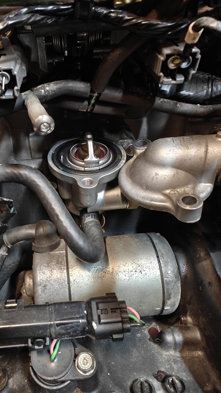

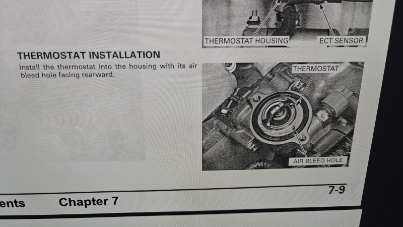

Just the one relay. Did the reset earlier today.....watching it properly and the fan came on at 115-116C. Will run it again tomorrow to see if the reset made any difference. if not I'm going to swap the relay (there are 4 identical ones) Was looking through a service manual (although it's for a 2004 model as 2006 doesn't seem to exist online) to make sure I hadn't missed something in the procedure for changing coolant and noticed this which I thought was odd as I took a picture of the old thermostat before I removed it and it was in the wrong position according to this and so the new one is also in the wrong position assuming this is still correct for a 2006. Doesn't really explain any of the problems though as it was working fine last year.
IMHO. You wouldn’t think orientation of the bleed hole would be so critical - if it was then you’d expect Mr Honda to have made it such that the thermostat would only sit in the one position
Exactly my thought too. Although I might just move it while how to get to it is still fresh in my mind
I notice that the thermostat has a bypass port shut off plate mounting to the bottom of it. If thermostat isn't aligned properly the bypass port might not be fully closed off which would cause overheating problem as with this port open full flow can't be achieved through the radiator as the coolant just circulates around the cylinder head, for quicker warm up purposes.
follow the honda instruction regarding the bypass hole. At least it is done properly even if it is not your solution
