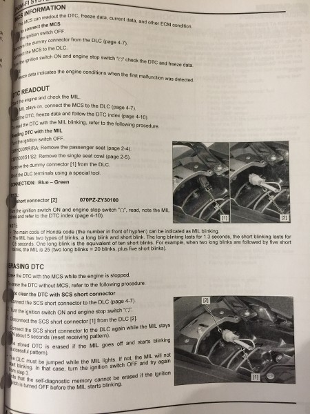

    does anyone have a detailed instruction on dtc fault clear using jumper on red plug?
    I have had a good search around and only found Vague instructions.
    Found a brilliant video for a grom but nothing else

    Thank you kind sir. Long shot but linking wire colour green to mint green?

    So which colours should you jump? The blue and green or the green and mint?

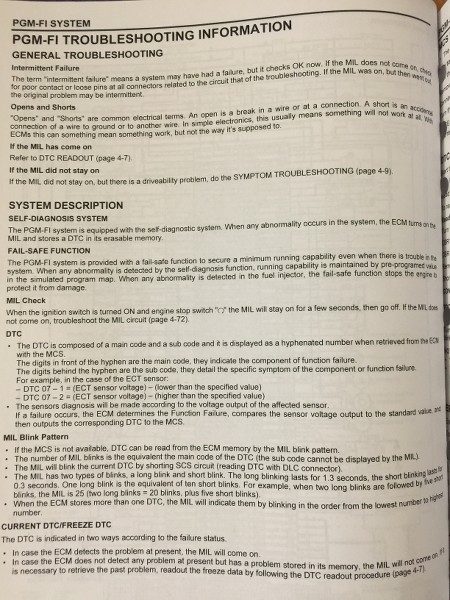

    What happened to the lights on the dash to indicate success?

    Follow instructions in vid, but you will not get a flashing eml light like the grom, just repeat process
    A few times and any faults should clear

    Can you follow this procedure to reset the TPS?
    Bike is a 2017 which has Tenkate loom and ECU with a DTC fault 71 - TPS fault. Bike starts but only revs to 6000.

    Did you ever figure out which colors to connect?

    167
    No, I bought a SCS DLC diagnostic plug instead. I'll dig it out later and check which pins are jumped.

    167
    Here are a couple of pictures of the diagnostic plug. Basically if you look at the connector on the bike end on like in the first picture you have to jump the 2 pins on the left hand side.
