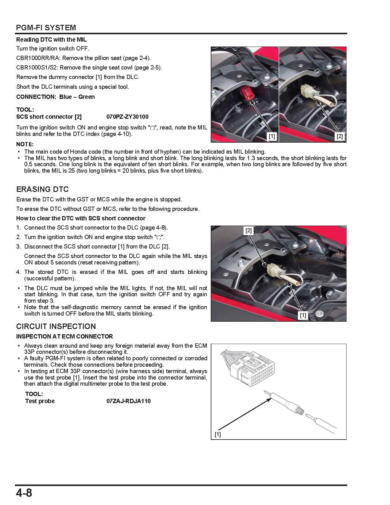

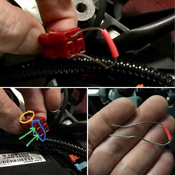

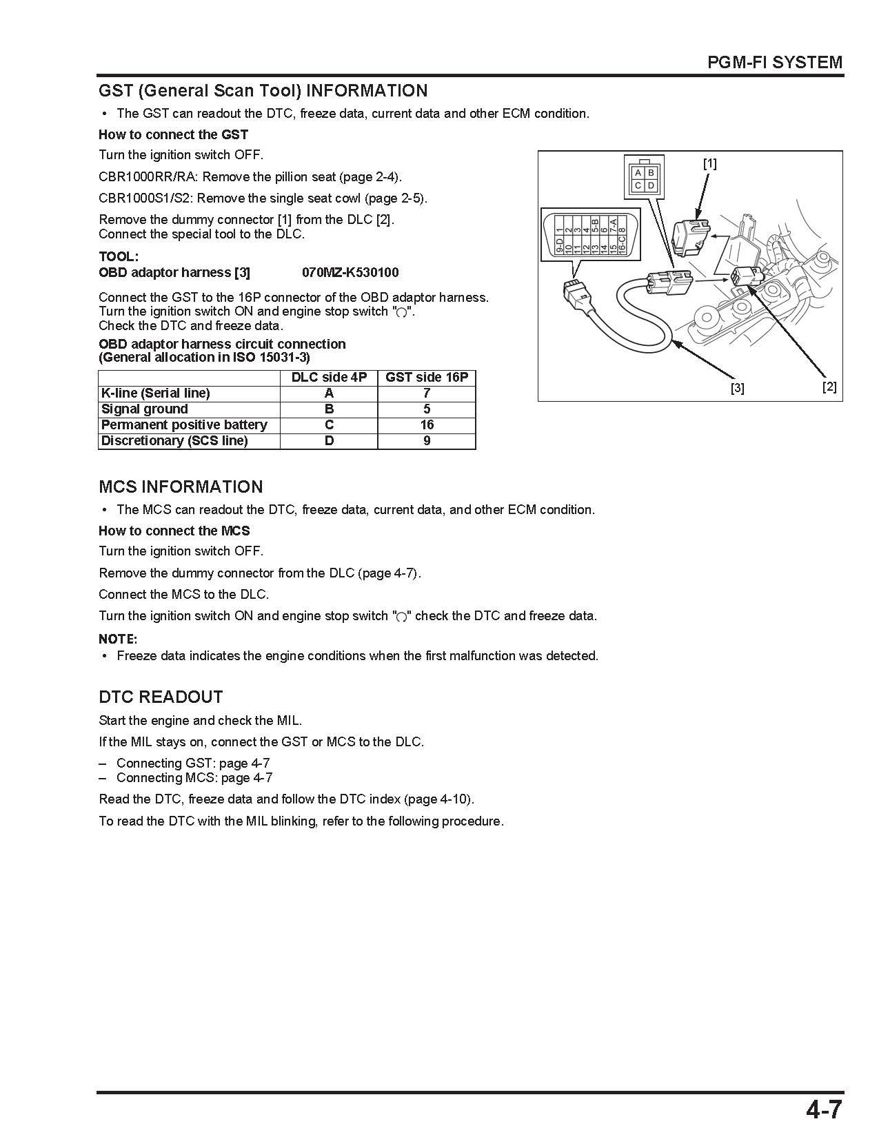

    Clearing historic codes doesn't require an ODB2 reader either.
    All you need is the instructions on page 4-7 of the Service Manual and a paperclip. :D

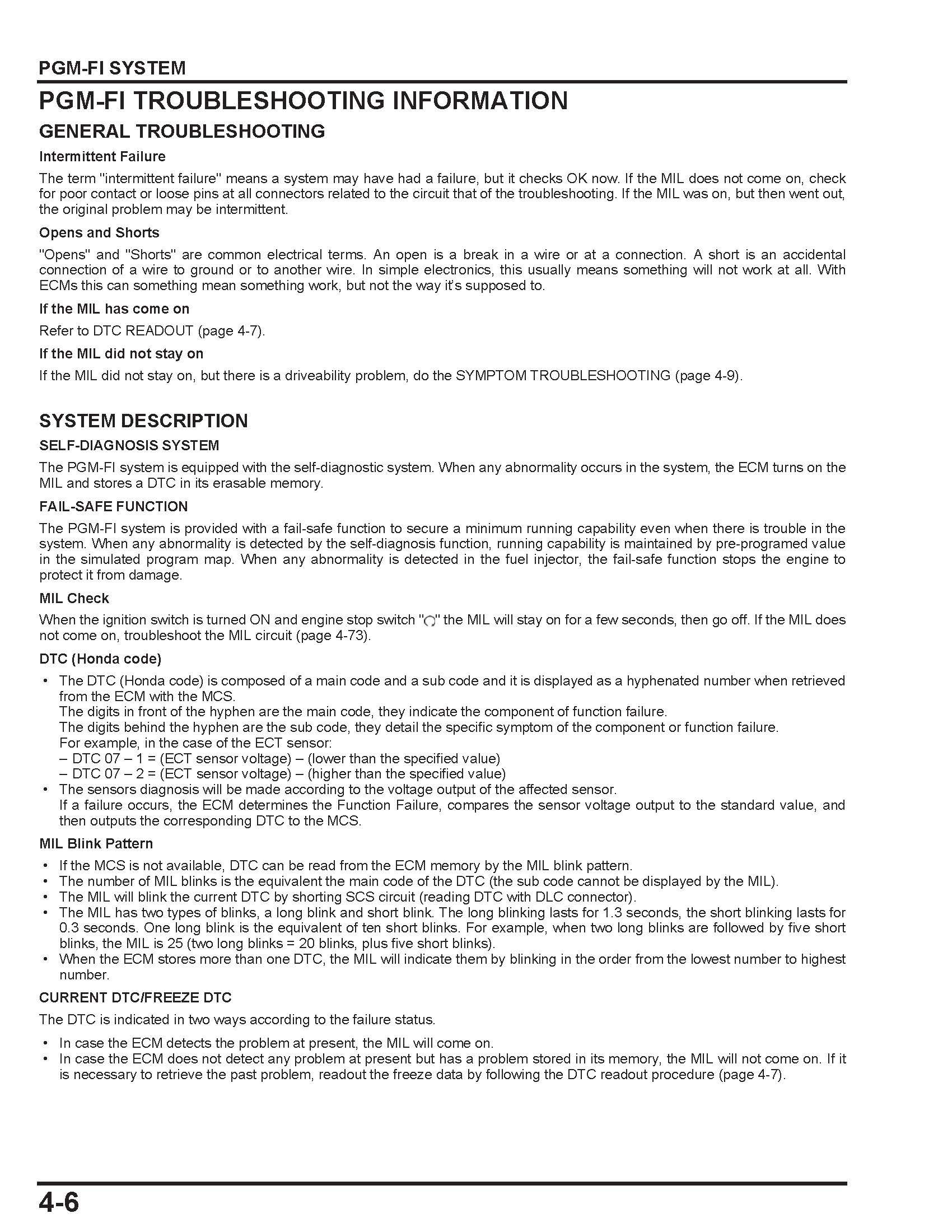

    You will simply be putting the bike into "read and clear code mode".
    You plug in the paperclip orientated in the DLC plug as shown - then turn the bike on a read the blinking check engine light,
    Count the blinks and that the codes - for academic purposes.
    See reading and clearing instructions.
