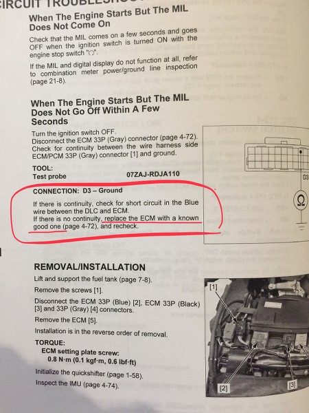

    What were the fault codes? Have him give this list to you.
    This is such a cop out. Literally, the test to validate this is to take a known good ECU and plug it in and see of the error "goes away".
    This can be accomplished by simply taking an ECU from a bike on the showroom floor and testing.
    There would be no doubt then - he would then be able to confidently say the ECU and or IMU are at fault and he has ordered you new ones and will let you know when they arrive.
    Does the dealer have another working Blade on the floor?

    I doubt a dealer would take any electronics off the showroom floor. If the bike in question has a fault it could break the new ECU. Not something I’d risk if I was the dealer.

    Then they better pony up and buy a test ECU as this is only way to complete many proper test scenarios.
