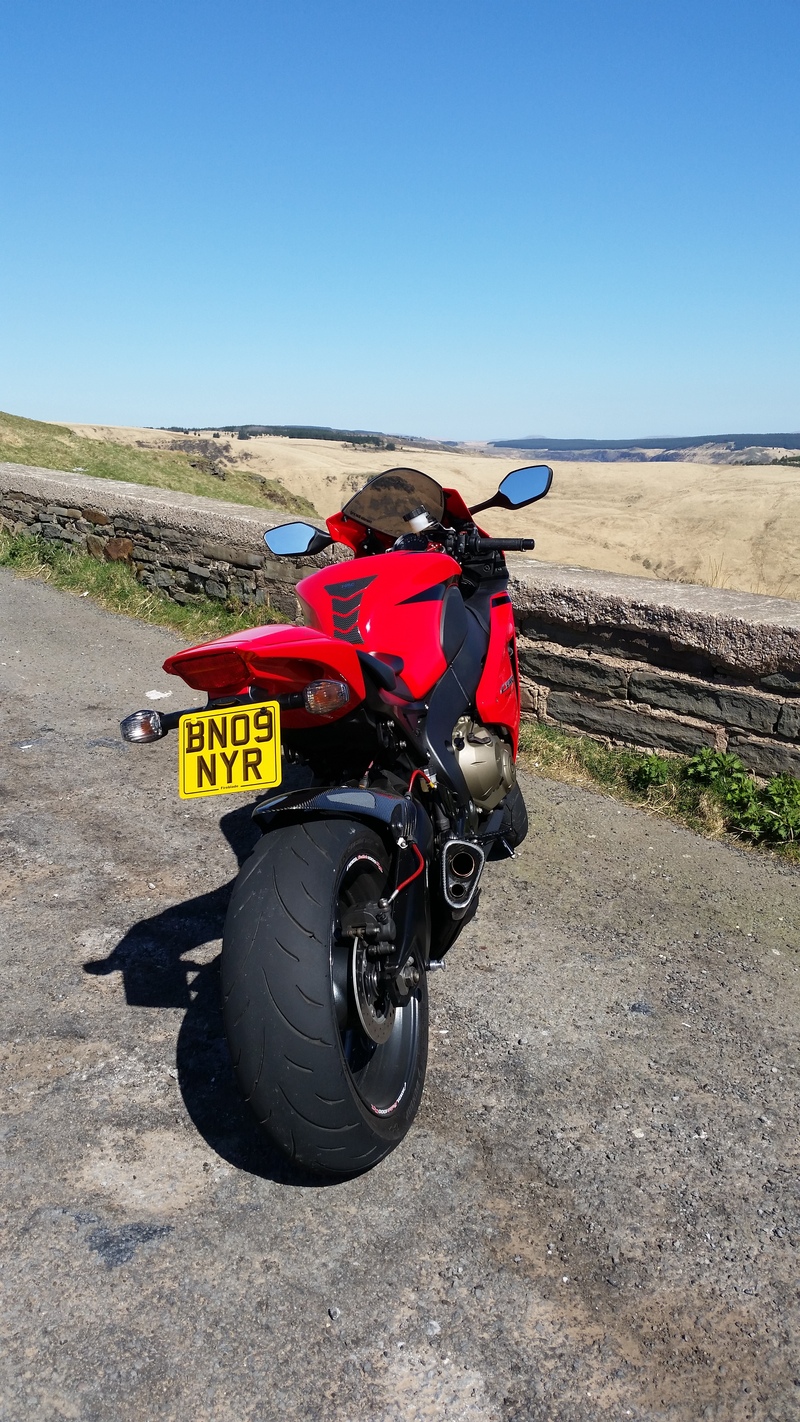

    55 on mine (09 Blade) What are these chicken strips you speak of:D
