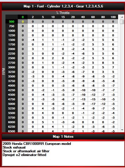

    I'm 99% certain that it can be mapped out ... and have so far installed (on a stock bike with exhaust valve disconnected) a Power Commander PCV with Dynojet O2 eliminator and the recommended map as shown here (lower rpm only as this is the area I'm discussing):
    It's a lot better with this setup... but I want to smooth out the roll on - roll off transition to make it a bit easier through traffic... i.e 0-5% range... circa 2000-4000rpm
    I've got three weeks till it goes to a mapping specialist but wondered if anyone on here has an experience of modifying the lower throttle figures to smooth out throttle transitions or even has a difference map for me to try - even better custom map for a stock bike!
    I'm thinking enrichen of the fueling at lower throttle openings would smooth things?
    Any suggestions?

    I have uploaded the map Simon sent me to the PCV and hopefully will be able to try it tomorrow (ice up here this morning so car today) ... will give me a good comparison between Dynojets base map they provided.
    However, the bike is booked in with these guys FW Developments | Services | Fuel Mapping in two weeks... and I'm pretty sure they will sort it hence don't want to fiddle too much... ;)
