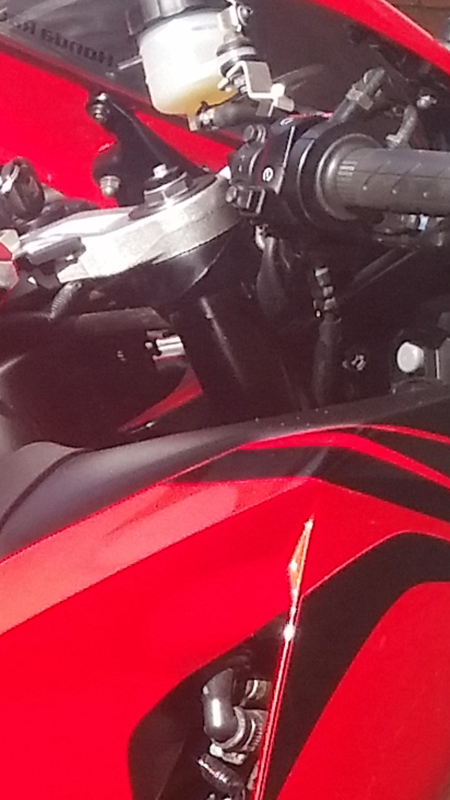

    I just zoomed in on the only pic I have which shows my fork top and....................
    ..........well, I'll leave you work it out! Must have been thinking of my Gixer! :D

    Couldn't resist ... :p
    I know which one it is but didn't realize how it is measured ... I'm used to rings on the preload ! :D
    My first Honda :p

    Not a million miles away except for the sag. Have they dialled in for the static sag rather than the Rider sag? Strange. Or have they just noted the static value? Is that on standard forks? Mine is much better than standard at 12 turns! It was too soft for me before. Much nicer on the front end now.

    15 full turns.
    Why is mine set at 12 Turns for 38mm then if everyone else's is around 6??

    Also if 7 3/4 was showing 42mm how can (less) 6 turns be showing 38mm? Surely it's now showing 9 turns (15-6) and the 7 3/4 was previously 7 1/4 ( does that make sense?) Or do I have it wrong?

    Easy answer ... I'm measuring mine from fully in ... ;)

    Exactly that ... 15-6 = 9 ...
    I forgot you measure comp and rebound fully in and preload fully out ;)
