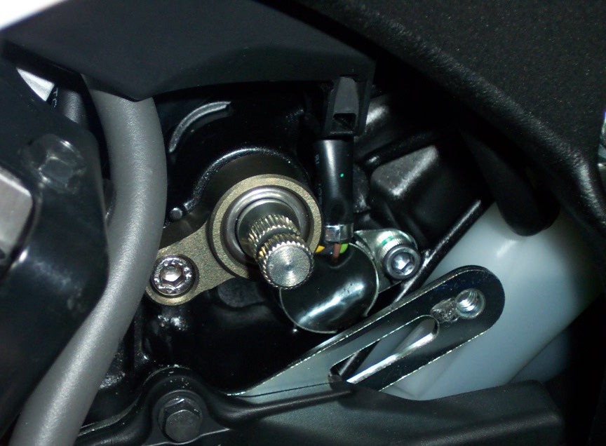

    within the above budget I have two spending choices for my RR8 :
    gilles tooling "shift holder"
    or a Sprint air filter
    Has anyone got any experience of or recommendation either the two? or are they a waste of money?

    Gilles FTW. It actually makes a lot of a difference.

    Both if you can afford it! Have the shift support fitted and definitely makes for more positive and direct feel to the change.... sprint filter now been in for 2 years... mines the dry cotton version that just requires blowing out with airline.... fitted this in conjunction with exhaust and airflap removal so hard to say how much difference the filter made! But if you do some research on previous posts it's the most free flowing filter on the market, used by many race teams and fitted as standard to Ducati R's and Superleggera models.

    I take it you both have the shiftholder fitted. Was it a direct swap without any mod to the bike?
    Are the rollers inside moving (line those on the chain)? If so does the kit need maintenance like a chain : cleaning & lubing?

    The shaft support is useful for everyone and not just track riders. It removes flex from the gear shaft and this gives a more positive gear change and helps prevent wear on the shaft and it's internal bits.
    It'll give you a better bang per buck than the air filter. Are you planning on getting a power commander fitted and mapped on the dyno? If not I wouldn't bother with the filter.
