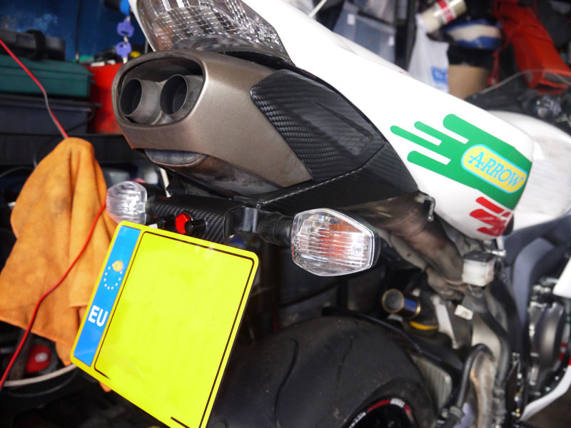

    I've not seen your view on the exhaust before, but am inclined to agree.
    For that reason I chopped the baffle out of mine an carbon wrapped the plastics.

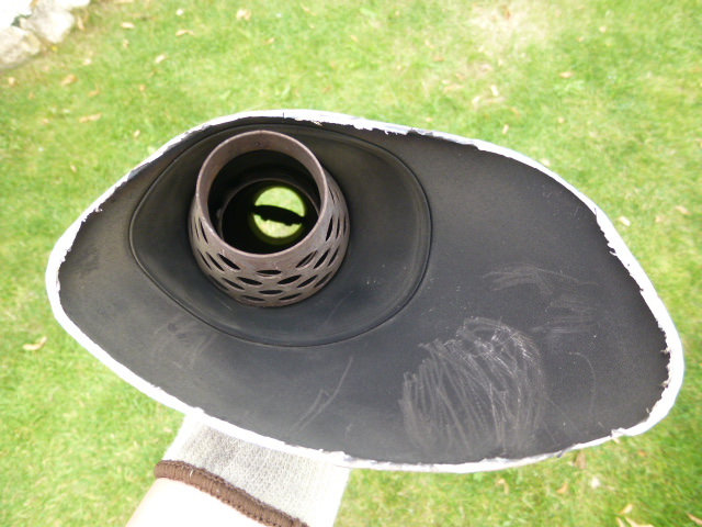

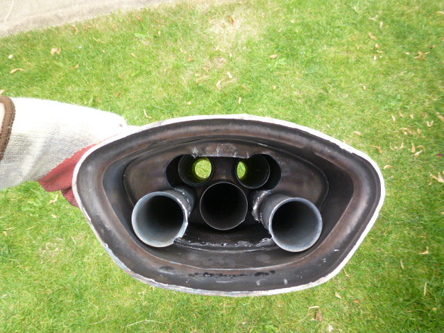

    Took a while to find the photos, but you can see where I cut all the way around the original weld line. The baffle is basically just a metal plate, which I cut a big section out of once the box was accessible.
    This is the rear section with the 2 exhaust pipes.
    This is the section which clamps to the middle pipe.
    Both halves were then seam welded back together. It's been like for a few years now and I have no plans to change it as I'm happy with the look & sound.

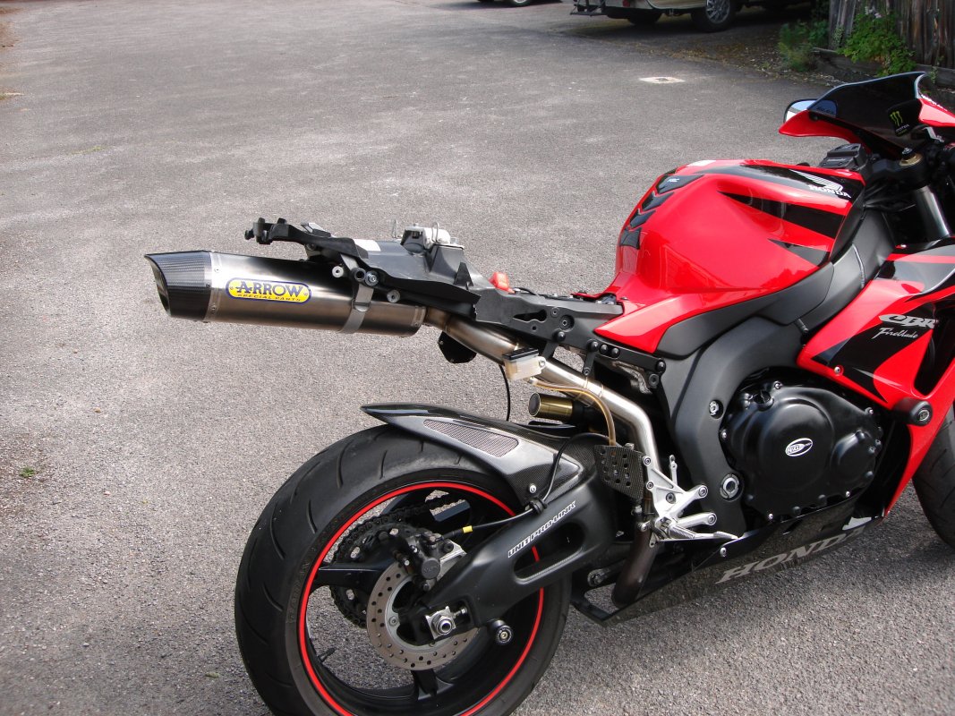

    During installation:
    Can't seem to find a finished photo at the moment, but I must have one somewhere.
    As nigelrb has said, this is one of the exhausts that does stick out further than the original.
