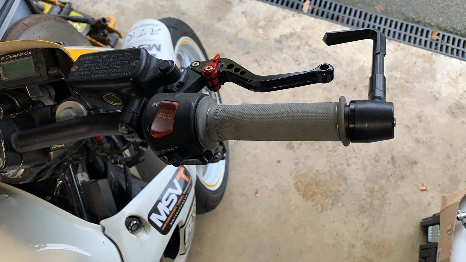

    This "simple" brake lever guard installation is turning into a right pain in the arse. I've got the original bar end weight inserts out, bought a reasonable quality universal fit brake lever guard and installed it. Issues I can see so far:
    1) If the bike fell on the brake side the force would push the universal fitting fastener into the handlebar hollow and the guard would jam against the throttle (the throttle tube overhangs the handlebar by about 2mm). Hopefully the Tip over sensor kills the motor otherwise it will be chaos.
    2) I've tightened the guard (proper tight) and I can still rotate it anti clockwise and loosen it as there are no "notches" like the original bar ends to stop if from turning around.
    Am I overthinking this "simple" universal fit brake lever guard?

    Which one have you ordered? The Gilles one would never be able to move into the handlebar far enough to pinch the throttle. The bar end is the right size to stop that happening. It also won't rotate once its tight either, the expanding knurled portion grips solid.

    Yea, seems to me that the knurled portion isn't very knurled and it doesn't go very deep on that one. Not much you can do about that really. You could try and wrap some coarse sandpaper round it and see if that gives a bit more bite onto the inside of the bar when its expanding.

    Very similar to the one I have, you could probably machine a collar between the guard and the existing bar end insert which is a better idea then using the generic inserts supplied. The generic ones aren't keyed and will spin around.
    I ended up making an 18 - 21mm top hat spacer 20mm long which goes between the guard and the throttle tube, I've also keyed it to stop it turning around. Think I'll end up getting a Gilles one as I don't trust this one on track, might vibrate loose.
