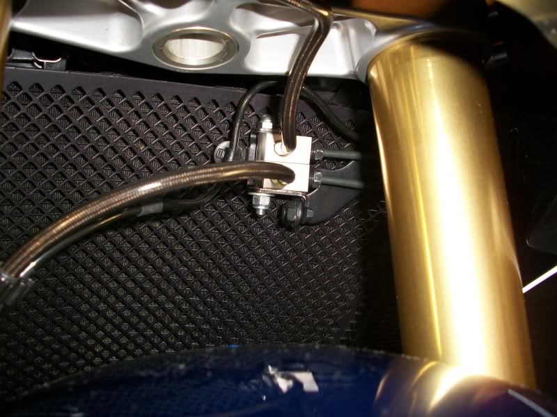

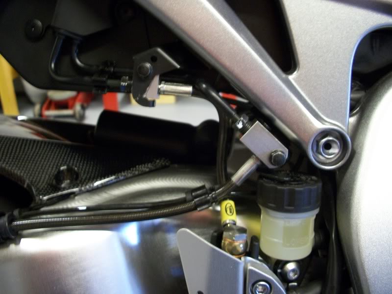

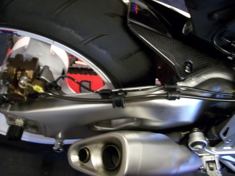

    It aint that hard mate just bleed as normal but as the man above says there about 220 240 a set!
    These and a brembo RCS make my brake mint!! ;)

    That looks great Bats.
    Whats in the kit?
    Is it just braided lines or are there other components?
    How many lines are there?

    You get 2 lines for rear and 2 lines for front got mine for a 100 notes of ebay cos the guy was scared to fit!! ;)
    They aint hard to fit just time and paitence to make it neat :) the bleeding was pretty easy bleed as norm ie master the calipers! then bleed all the metal pipe uninons then back to master and calipers hey presto you got a lever!!
