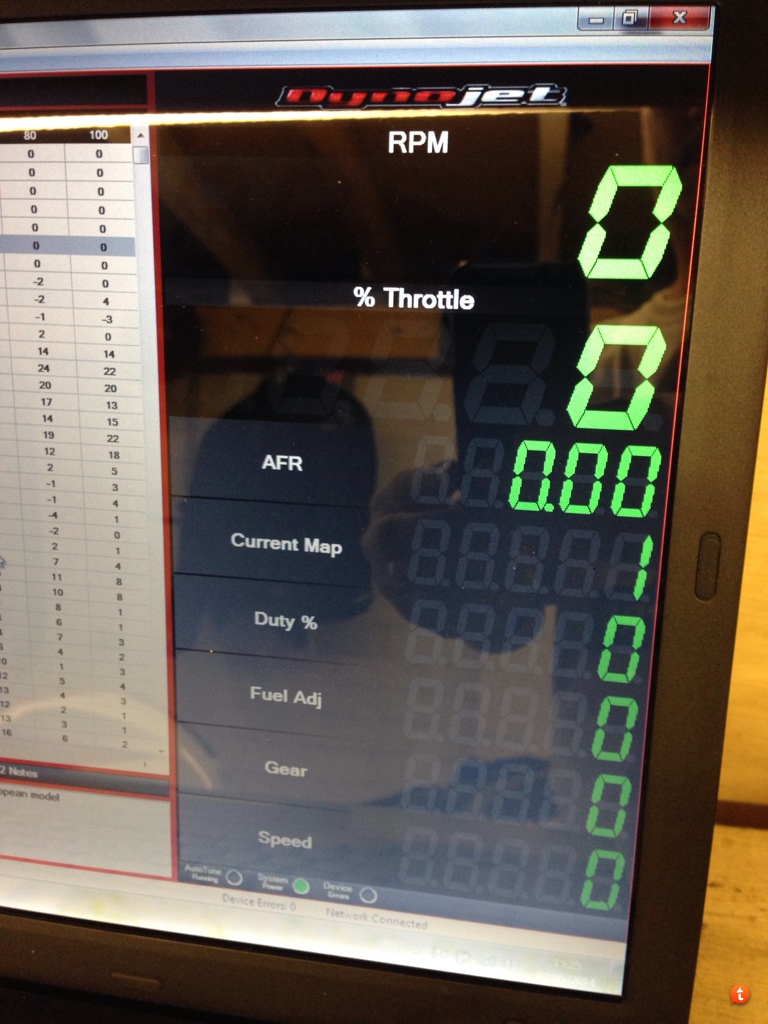

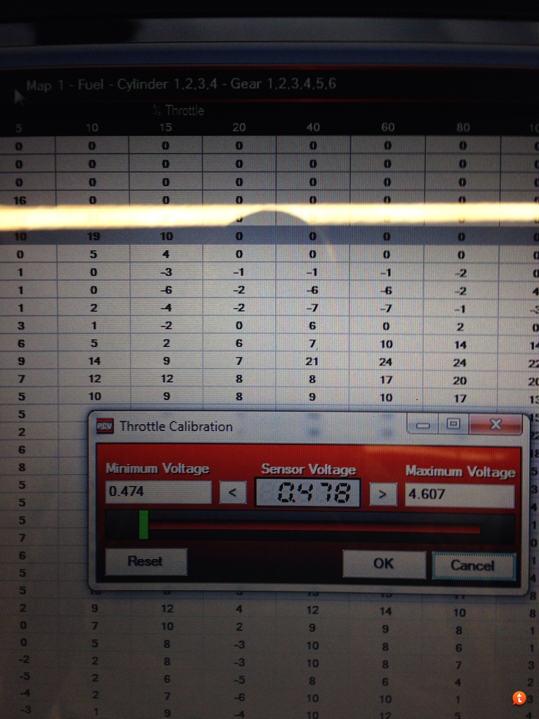

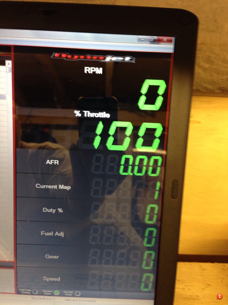

    Hi guys
    Does anybody no how to calibrate/reset the throttle position sensor on the power commander 5 I have the instructions but after googling a few forums have stated that these instructions are now out of date and the bike now needs to be running when doing this ?. The reason I need to reset calibrate is that the bike idles at about 1500 rpm which is way to high by about 500.
    I can get the calibration screen up on PC software just need an idiots guide on how to do it correctly tried ringing dynojet uk but still awaiting the call back
    I have included a few pictures of the calibration screen and the throttle open and fully closed
    Many thanks
    Brian

    TPS CALIBRATION
    It is important that the PCV software TPS read 0% when the bike is fully warmed up and at idle. If it needs to be reset make sure the bike is fully warmed up before resetting. With the engine on, click on Reset, open throttle to the stop and close, then click OK. If your bike has fly-by-wire throttle only reset the throttle position on a dynamometer.
    this is off pcv instructions. You could download the pdf file if you search for it, might be updated from the one you have.

    Might be wrong but never found it necessary to have the engine running whilst calibrating the tps, only the ignition. The TPS is active when the ignition is on, other bikes like Suzukis require the engine running.
