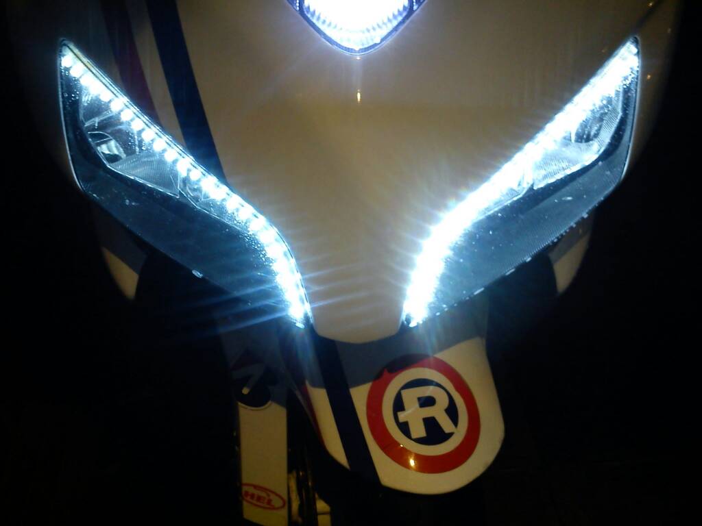

    These are my lights [​IMG][​IMG]

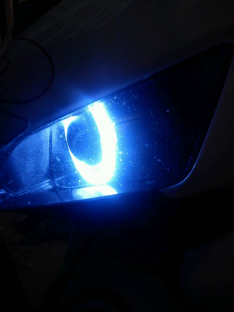

    Hello tgosai, looking at the pics of you're headlight conversion it looks as tho you used 2 of these:- http://www.ebay.co.uk/itm/310561308506?ssPageName=STRK:MEWAX:IT&_trksid=p3984.m1438.l2649 Am I correct? If so, did you manage to get them to fit without having to hack/cut the original head light fitting about? I'm looking at doing this conversion myself and I think if I can get these projectors to fit it should be possible to fit H4 hi/lo bulbs so that I can run with 2dip or 2heads on. Also what's the supplied bulb? Is it the type( H4 hi/lo) where the 'filament' is re-positioned or does the actual reflector move?

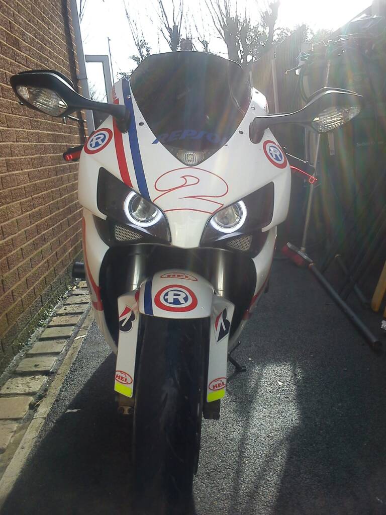

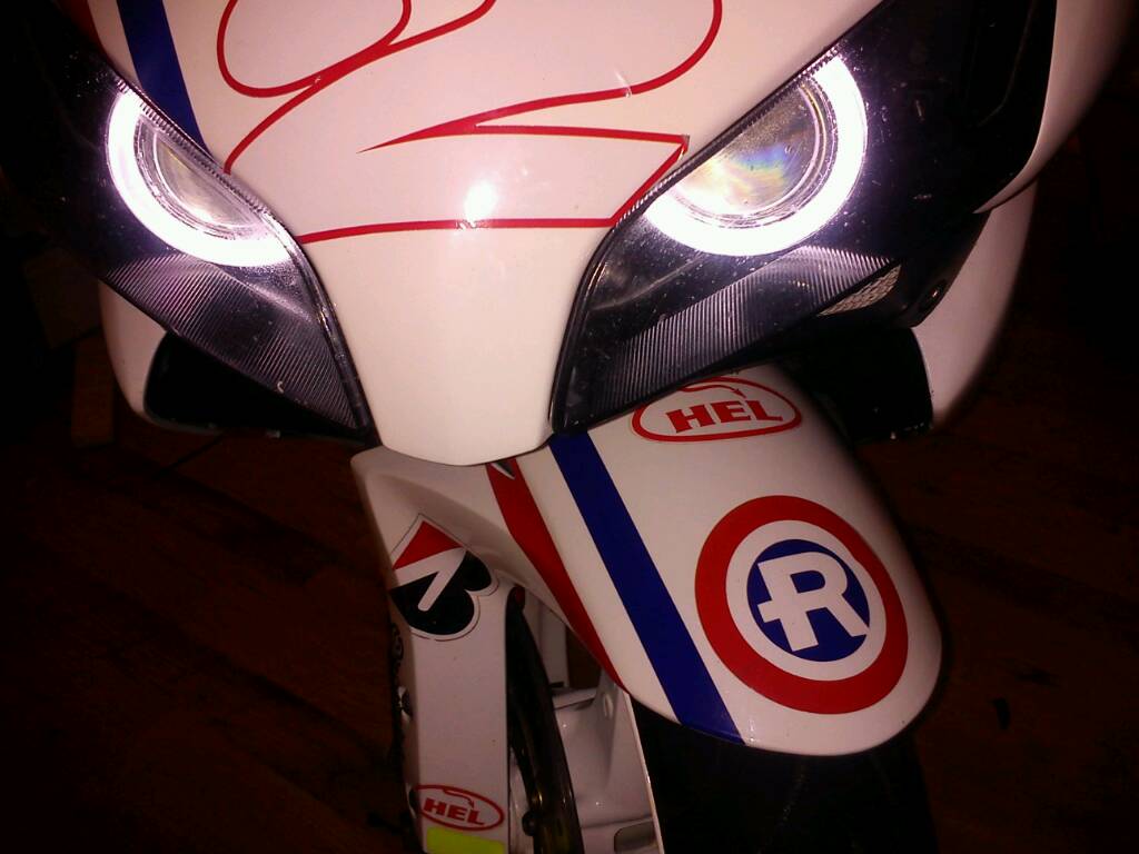

    Hi Nick, yeah this is exactly what I used, minus the LED strip lights. as far MOT is concerned, I think it should be fine as long as the beam level is adjusted correctly. you don't need to cut any part of the new headlight unit and I used the H7 bulb kit, H7 are the standard fit.
    the projectors have an actuator that adjusts the beam from low to high, so you only need one bulb in either side and the actuator flips a reflector when you want high beam.
    the wiring seemed to be the hardest part, so plan it and take your time fitting it.
    good luck with doing yours, take a while but the end result is worth it.
    Tim

    Mines on the photos above mate didn't mean shit as in shit :thumbup:lol just the chrome don't look right with the projector :) and from doing my mates 2009 blade I'm guessing your projector is up against the light glass? With not to movement for the adjustment not very good. I've fitted Leds & projectors [​IMG][​IMG] u can buy proper brackets from USA or make them, I've made all mine out of allium then painted matt black (heat proof paint) . :D
