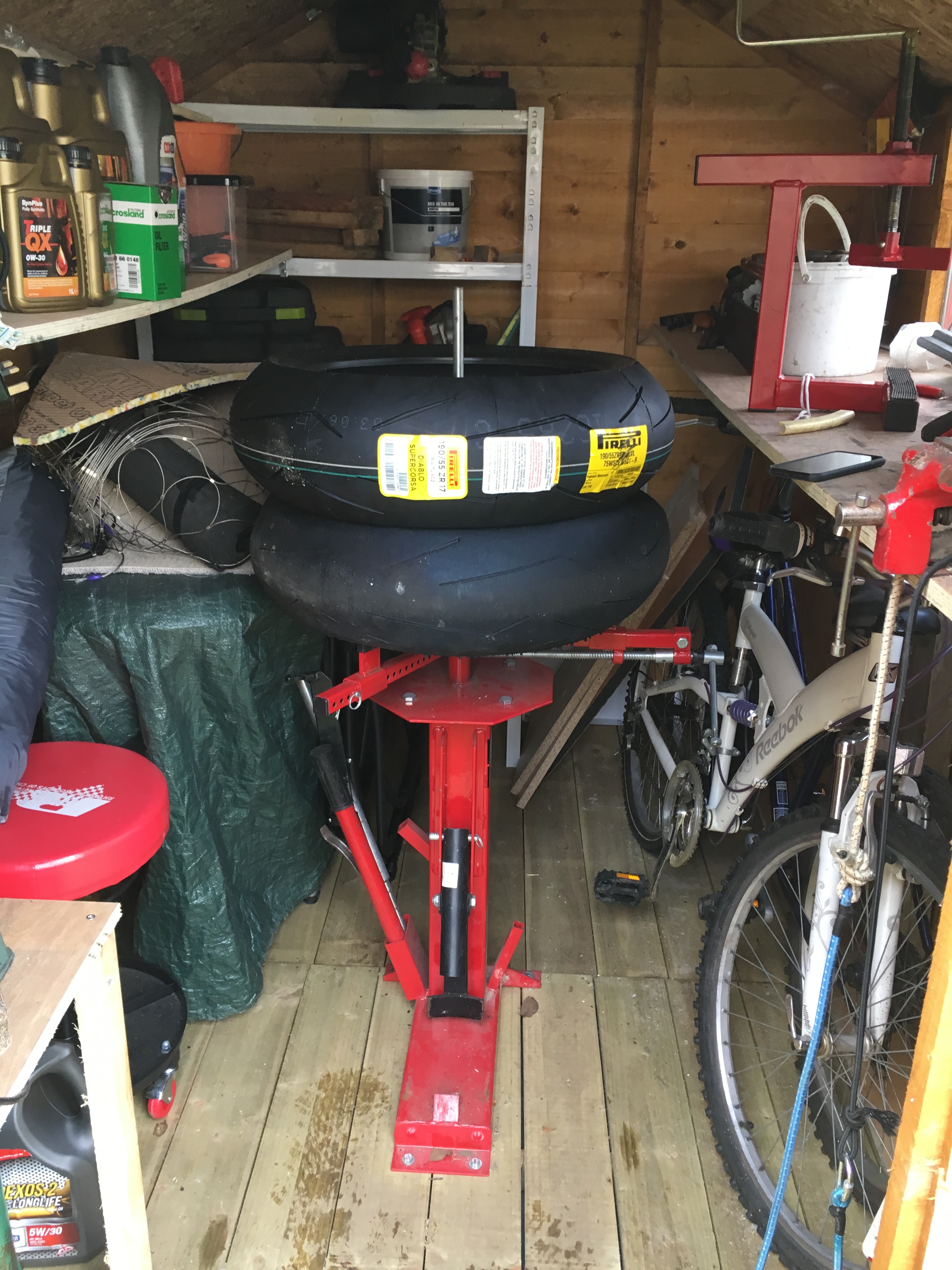

    I do my own. The gear costs a bit, but it depends how much space you have and if the convenience outweighs the hassle.
    Otherwise just pop to your local track day and get them fitted there.

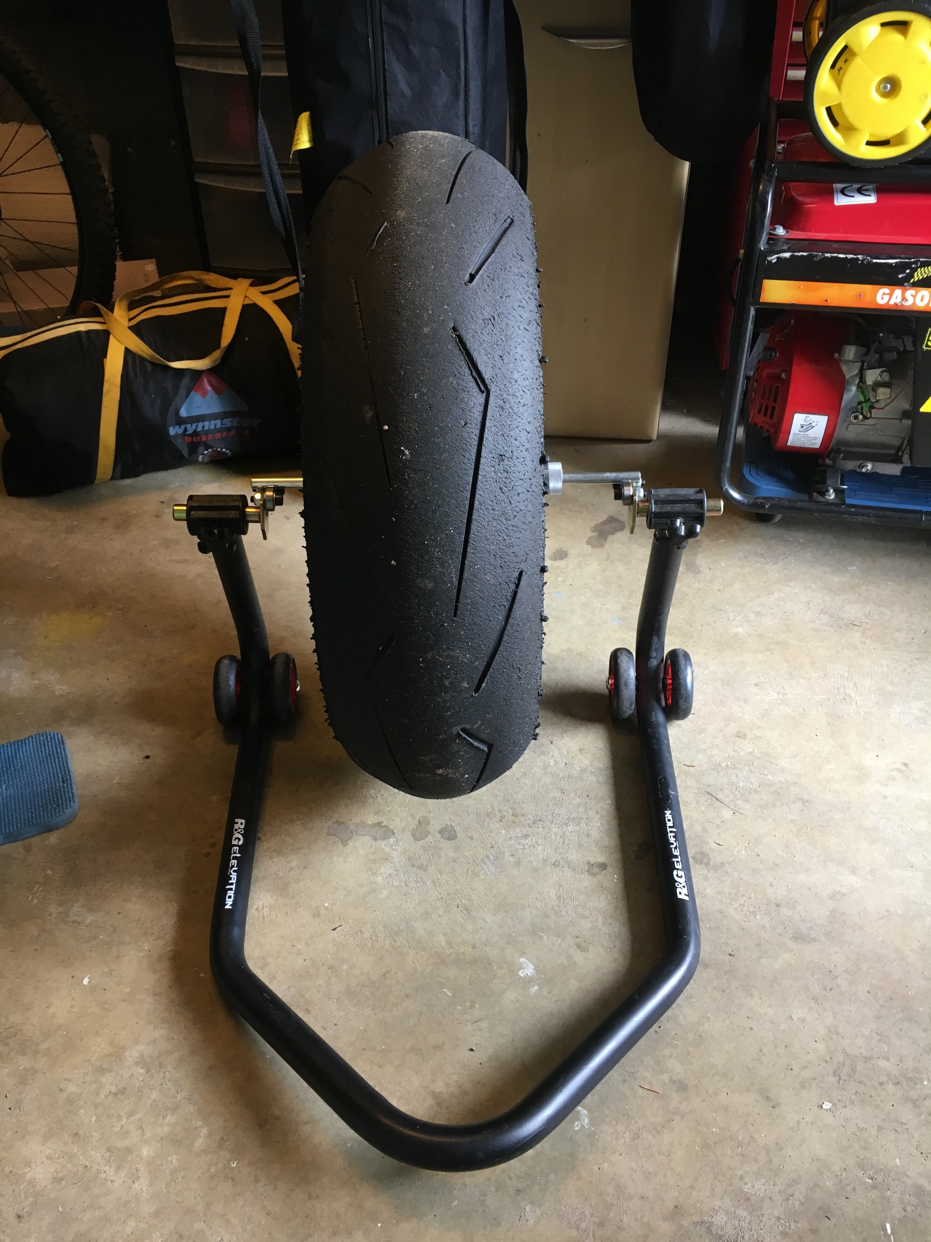

    Edit: I noticed you use axle stands. Is the rod going across a coned balancing rod, or is it just the axle out of the wheel?

    TBH after all the research I've done, I'm coming to the conclusion that tyre levers are the absolute worst tool for the job. The two methods that I'm interested in is the table with the long bar (like @Muffking posted above), or the zip tie method which intrigues me a lot.

  17. Muffking
    5,760
    2,788
    It's a coned balancing rod with a couple of bits with roller bearings that mount on the paddock stand. I'd happily swap to a proper balancing stand though.
    FWIW the same kit I have is for sale on TDR..
    http://www.trackdayriders.co.uk/tdr...re-changer-plus-the-tc963-bar_topic76620.html
