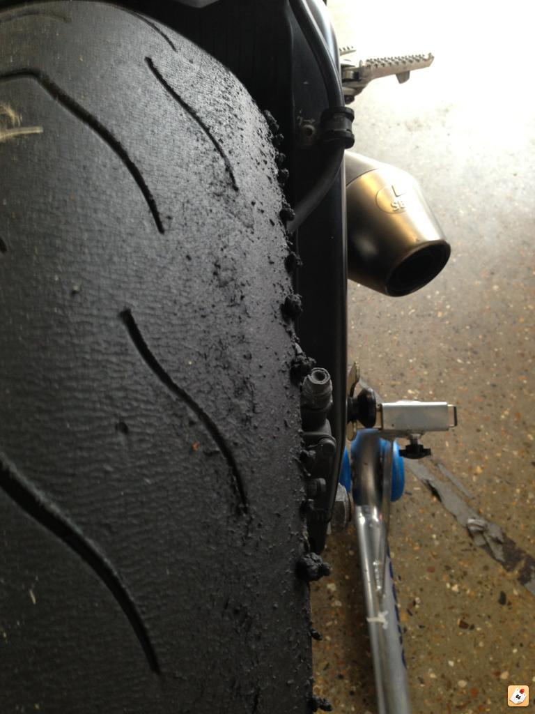

    Was that your dry tyres in the previous pics mate? Looked from the bobbles on the outside of the tyres that maybe they could have dropped a couple more psi? The middle section had a nice healthy orange peel ;)

    That was jimbos tyres nav i wasnt at brands and even i was i would of been in no state to ride.
  14. Jimbo Vills
    Yup, they were mine - running at 27/28 cold??

    To me that looks like normal tyre wear tbh no cold or hot tearing of the tyre. If anything it just looks like you were fukin goin for it jimbo, good man.

    Ha ha cheers mate.... Need to get some warmers, was getting bad cold tearing on Indy last time out, but gp long laps means you warm them up properly on the sighting laps.

    I would say that is too high a pressure and similar to how my dunlops were wearing at 27 until I dropped to 25 cold. I don't think you should get any bobbles if the tyre pressure is right, unless someone can correct me?

    My tyres looked like yours after first session out at Snetty Jimbo then I checked with tyre guy and dropped 2 more PSI and the rear end stopped squirming when coming out of the corners and felt a million times better and gave me so much more confidence ;)

    Tbh it felt great so didn't change... Be interested to hear from the more regular track guys if the wear is normal or not?

    Yeah that would be good to hear everyones opinion. I just put my tyres in the track day tyre guys hands to get right so each session I came in straight to him to check wear and pressure. He was the one that said the rubber shouldn't bead if pressures are spot on but like you say Jimbo if it feels right then it feels right. I just want to get the best out of the tyres and not destroy them like my friend did his brand new BSB's after one TD :)
