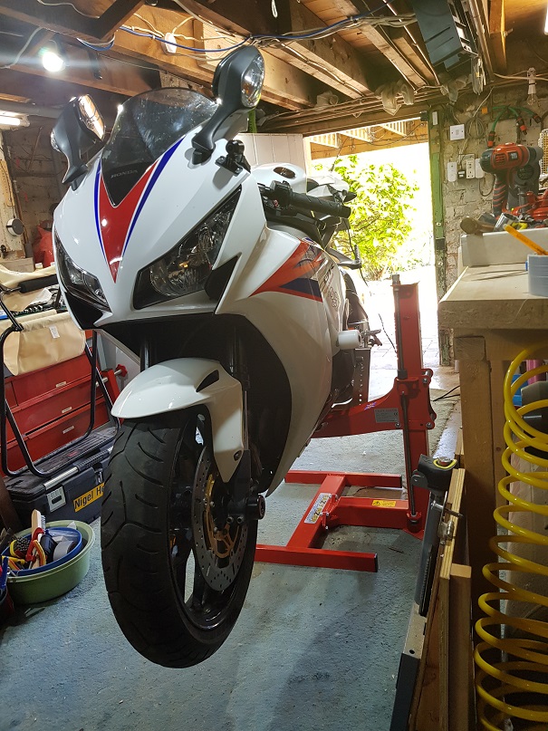

    Being an old git the idea of a bike lift rather appeals and having the wheels hang free would be a nice detail.
    Does anybody have any experience of this device?
    I'm worried about the front mount as all I can remember there is plastic and pipes, so not very load bearing.
    Also it's getting the fairing bits off that would be nice not to do grovelling on the floor.

    Have you got any photos of where it mounts underneath? intrigued by it!

    I'll try to get pictures and write it up later.

    I have got a question nigel
    You have took the picture with two other stands present,
    Do you have to use these two stands before you put the eazy under it?
  17. Nigel H
    Nigel H Active Member
    Jun 26, 2018
    224
    227
    The one on the front wheel locks the bike vertical, the rear stand just lifts it so there is room for the front support to slide in.
    That is a big steel lump with a over half a cm of rubber on it.
    Then wind the lift up until the brackets reach the peg mounts then apply the u-bolts.
    It may be slightly overkill but the last thing I want to do is drop it.
