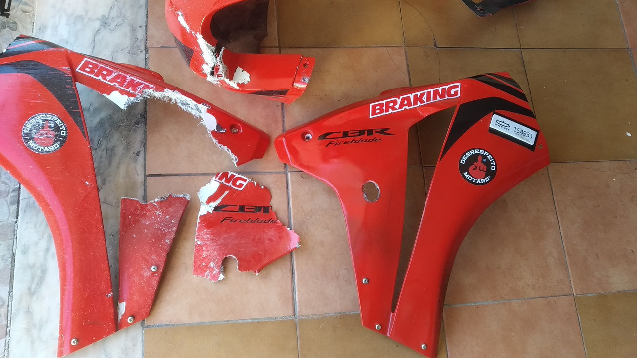

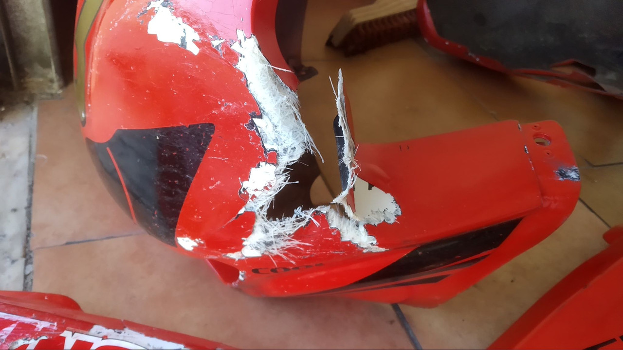

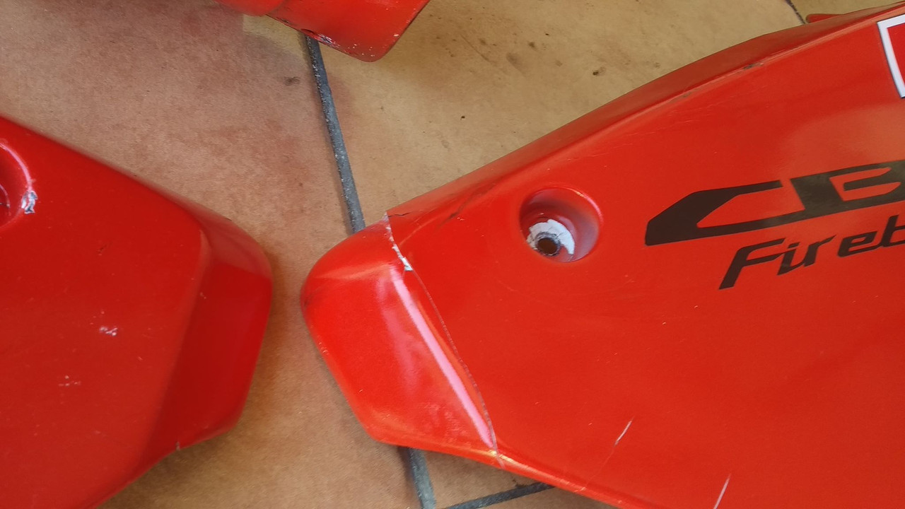

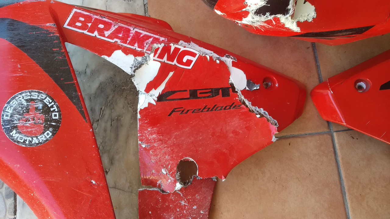

  20. F1CT1C10U5
    F1CT1C10U5 Well-Known Member
    Dec 29, 2015
    587
    271
    Fairing damage... Nothing that can't be fixed
