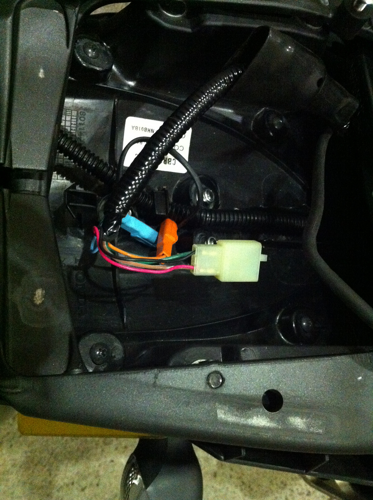

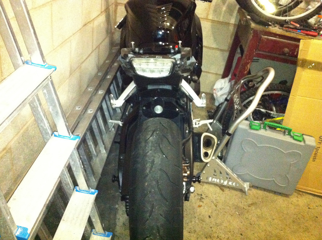

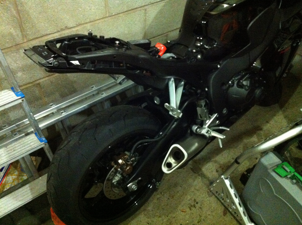

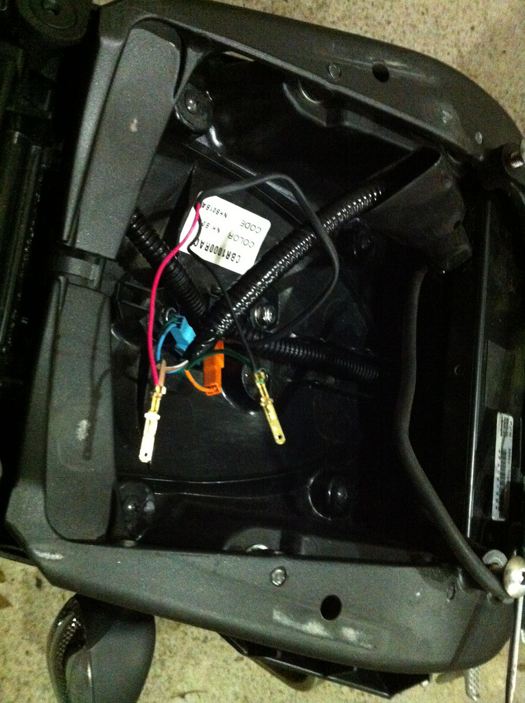

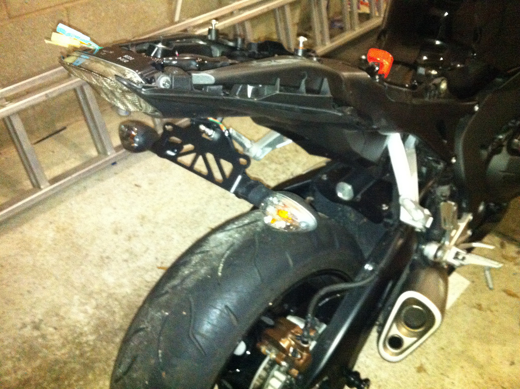

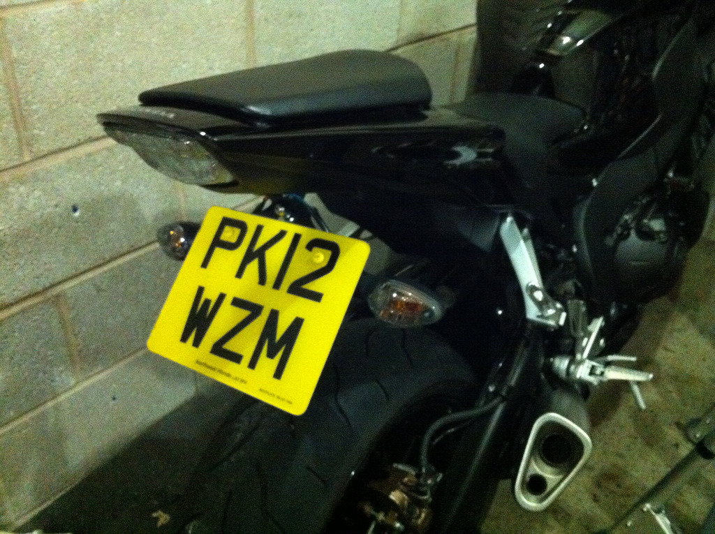

    Tail tidy is now fitted. I worked out that if I took the rear light plug apart I would not have to cut into the wiring loom. So I took the plug apart and crimped the new wires into the old rear light plug then reassembled it. See pic. Quality of pics not great as I just used my phone for them.
