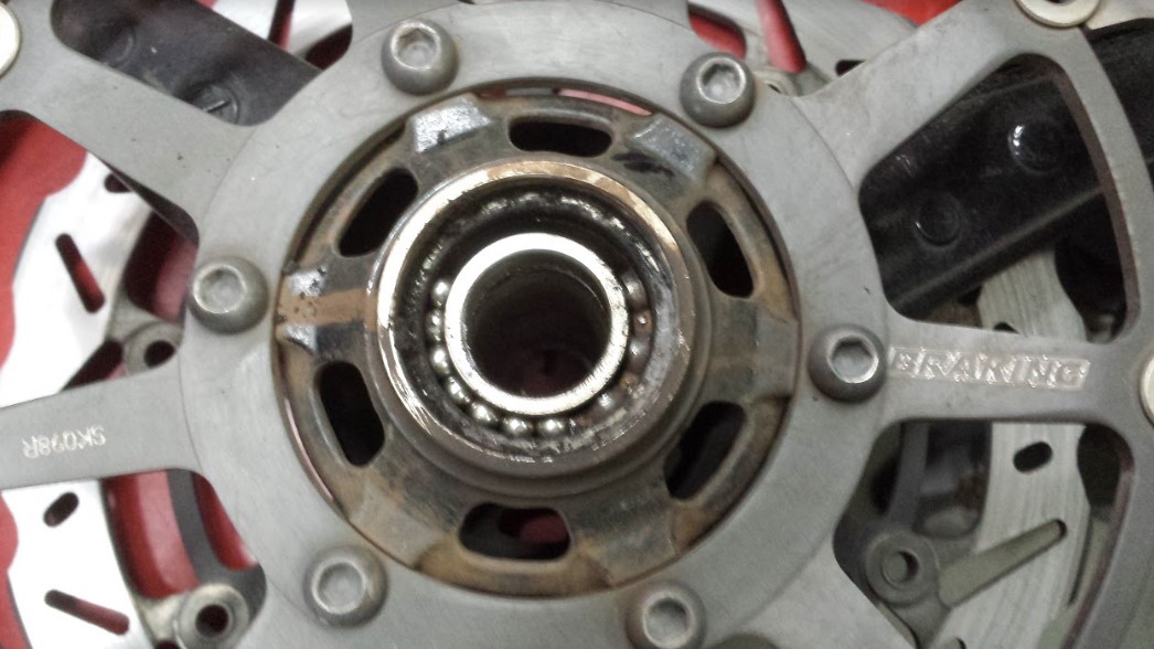

    I think I can beat that...

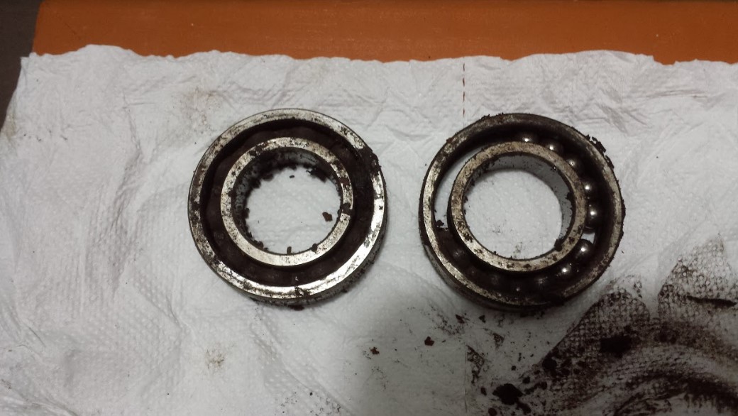

  12. F1CT1C10U5
    F1CT1C10U5 Well-Known Member
    Dec 29, 2015
    594
    275
    It was a couple of years ago, maybe 3.
    February 2015.
    Had the bearings replaced, those were roughly 2 months old. I noticed sometimes the front becoming "loose", wobbling. I could turn the handle bars a bit, and the wheel remained in the same place.
    I'll try to explain this in English, but since it's not my primary language, bare with me.
    Turns out those bearings were not suitable for my bike, since they had the bearings "visible". They should have the metal spheres protected by that plastic cover.
    Since i'm an all year rider, and this happened in the "rain season", the spheres started to rust, and the bearing started to come apart. You can see in the 1st photo of my previous post all the rust residues in the rotor...

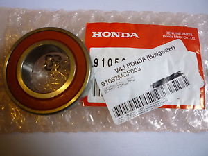

    Thanks, but now I know what to look for... P/N: 91052MCF003 ;)
