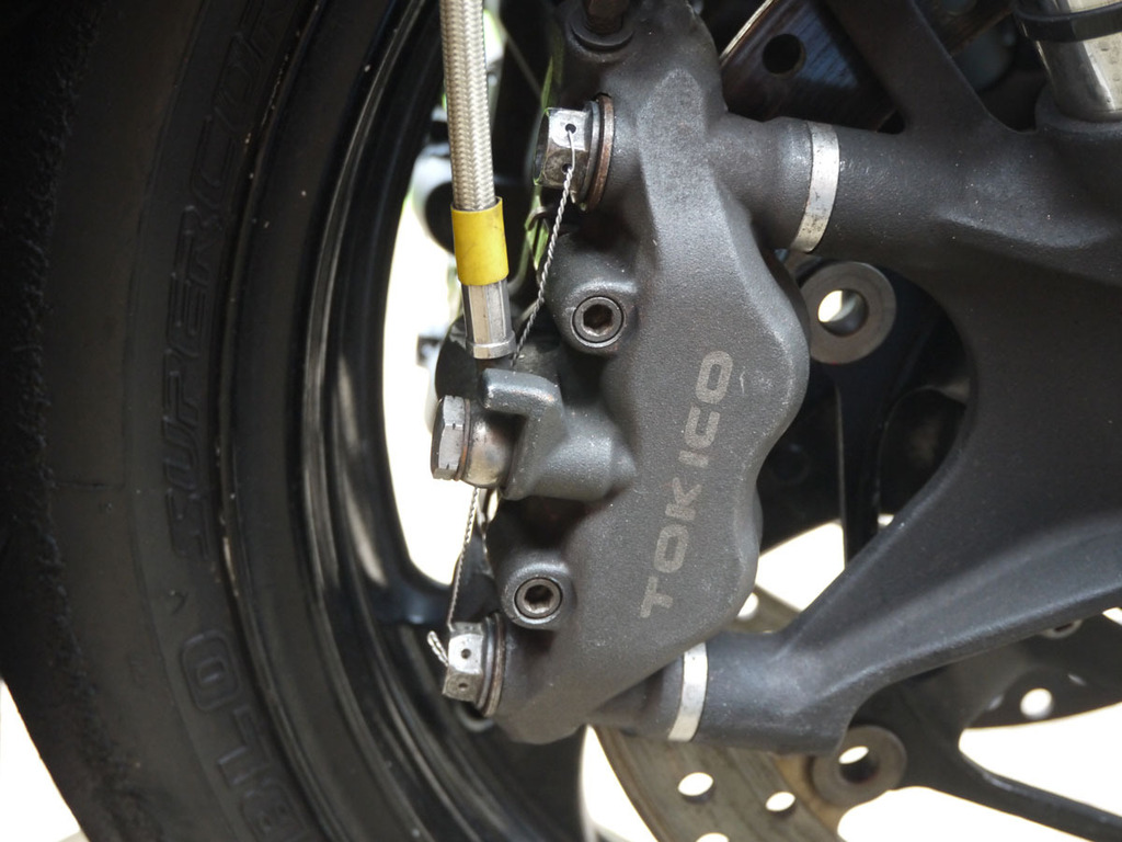

    Will 06 discs fit my 04 . I'm thinking they are different offset ect but not sure.
  2. Muffking
    4,606
    2,122
    Offset is the same, but diameter is different. The RR6/7 adds spacers between the calliper & fork leg, without these the 06/07 discs won't fit the 04/05.

    Spot the silver spacers that allow for the larger diameter discs.

    I'm loving the safety wire! Good work!
    @mk3golfcab . I'll bet you took the trouble to do this.
  8. mk3golfcab
    mk3golfcab Well-Known Member
    Feb 4, 2018
    2,769
    1,577
    Not my handy work this time @Black & White :)
