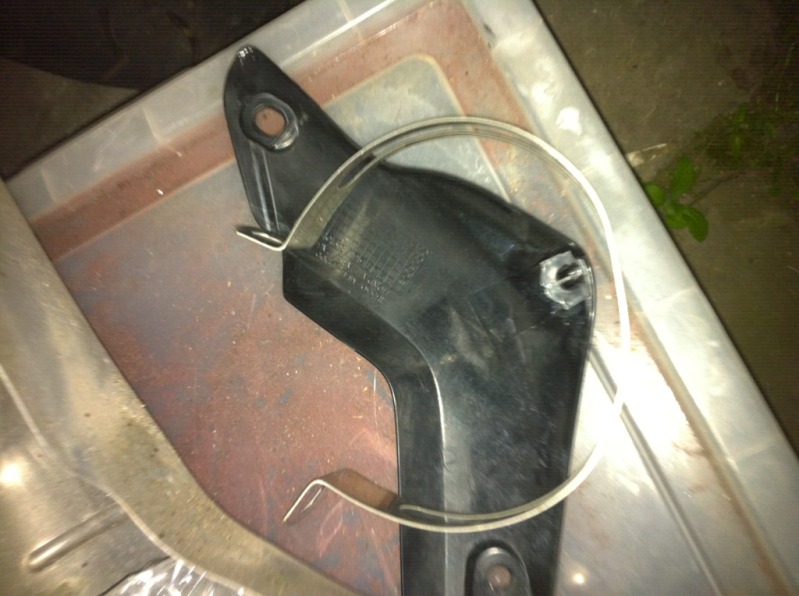

    Sounds okay, but i was unable to secure it as it seems i have the incorrect bracket!
    This is what i got with mine..seems similar to your bracket.. but i have the bit that bends and bolts onto the bike missing..
