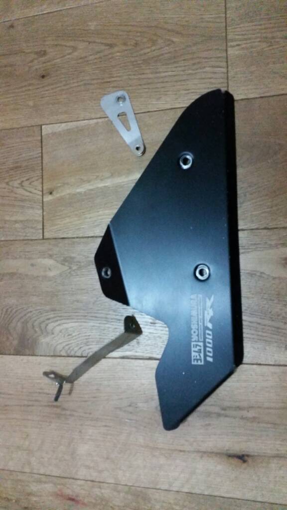

    Can anyone tell me how the infill goes on..
    It came with 2 brackets.
    Thinking the smaller bracket goes from the infill left hole to the bottom but were the fairing is attached to the bike..?
    Can't figure out the other bracket..
    Anyone got any pics or figment..
    Going on with a Austin can..
    Thanks

    The smaller bracket attaches to the rhs hole and onto your last lhs fairing mount.
    The larger attaches to the top hole and onto the exhaust header retention bracket using the stock bolt.
