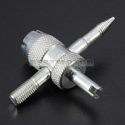

    This type of tool is cheap (first listing I found!), small and doubles up as core remover and valve puller. Some of the larger valve pullers are more designed for car wheels with more room to work but the tool below is small and easy to work with in the confined space especially on the front with the discs on.

    Well feck me, that's what it's for. I've had one of those for years and never knew it was a valve puller too. I even ended up buying one of those longer ones for cars too.... Dohh!!!

    Thick question time, how does it work as a puller, or at least how do you use it as one??:eek:
  8. Muffking
    6,018
    2,942
    Cut the old valve off, push the new one through the wheel and screw the tool on where the cap goes, then pull it hard to the valve pops into place.

    Here's one perhaps for Craig then.
    If the bottom end is for removing the core, the top bit is for pulling the valve through, I'm guessing the left bit is for re threading the valve, but what's the pointy bit on the right?

    I would best guess the pointy bit is for the initial recutting of the thread hence the taper, the wider part is for the main cutting once you have made sure its not going to go in cross threaded using the pointy bit, but that is only a best guess.

    I think the pointy end is for deburing the end of a newly drilled or cut end where the core is to be fitted before running the tap end down it to cut the threads.
    Never actually used either the threading or the opposite pointy side tbh. :rolleyes:
