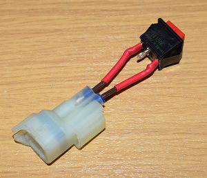

    Wired a normally-closed push button across a plug to be that damn diagnostic plug that you're supposed to insert/remove.
