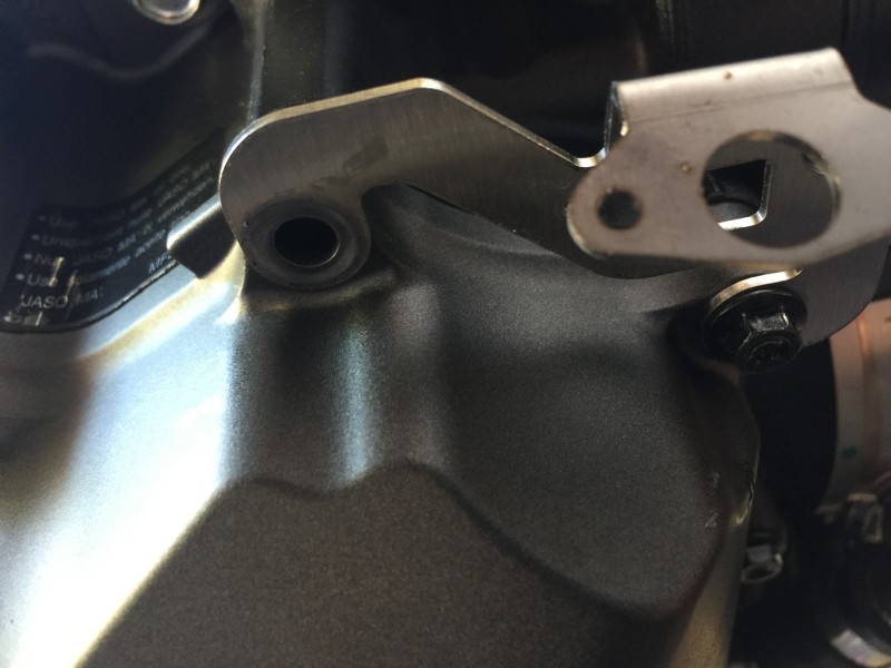

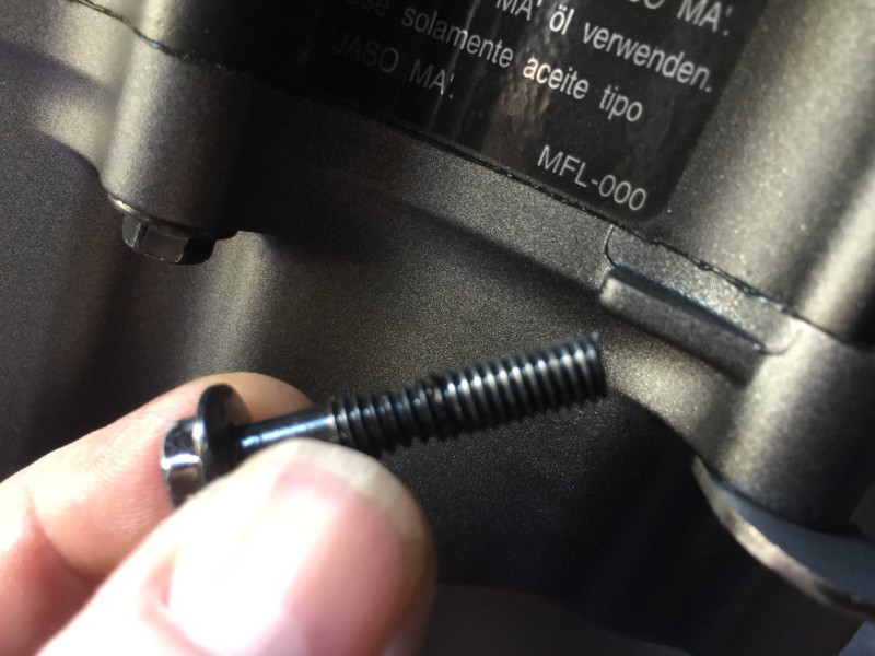

    Did you ever find the source of the leak?
    I think I have found where I am about to have a leak. I am installing the Ten Kate fairing mounts, 2 of which attach via the sump bolts the way the OEM left bracket does.
    When I removed the one bolt I saw it was damp with oil and stretched to almost breaking off. This could have been a nasty surprise had the bolt stretched and snapped while re-torquing.

  14. RC45
    RC45 Active Member
    Jul 26, 2017
    435
    299
    This isn't the first substandard fastener I have come across on the bike. Hopefully there are no bolts made of cheese on the inside.

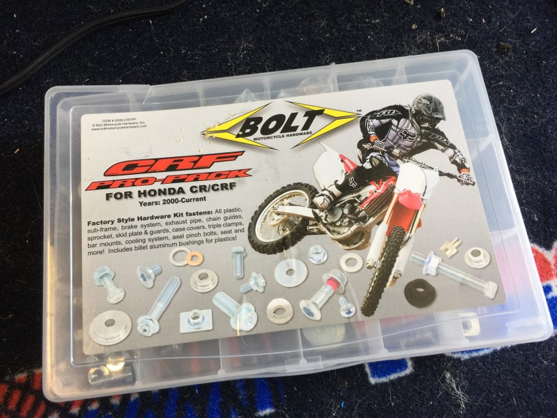

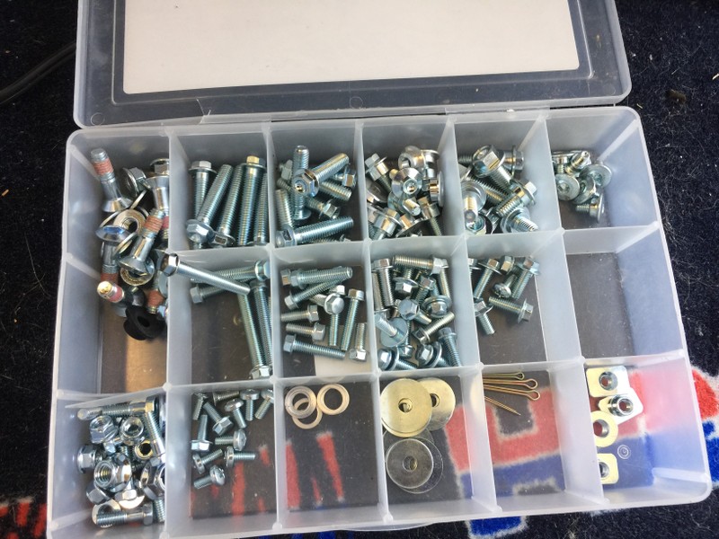

  16. RC45
    RC45 Active Member
    Jul 26, 2017
    435
    299
    Yes - I have some spares on the shelf (I always have 1 or 2 of the Honda CRF MotoX spare bolt kits on hand.
    I will be replacing all the sump bolts with Ti bolts next week.
