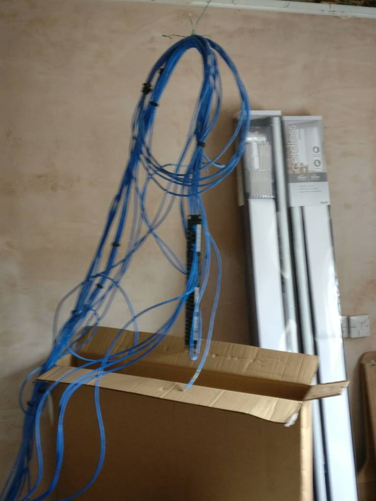

    If you ever rewire a house it is a great time to network it.
    Yes I am a geek [emoji4]
