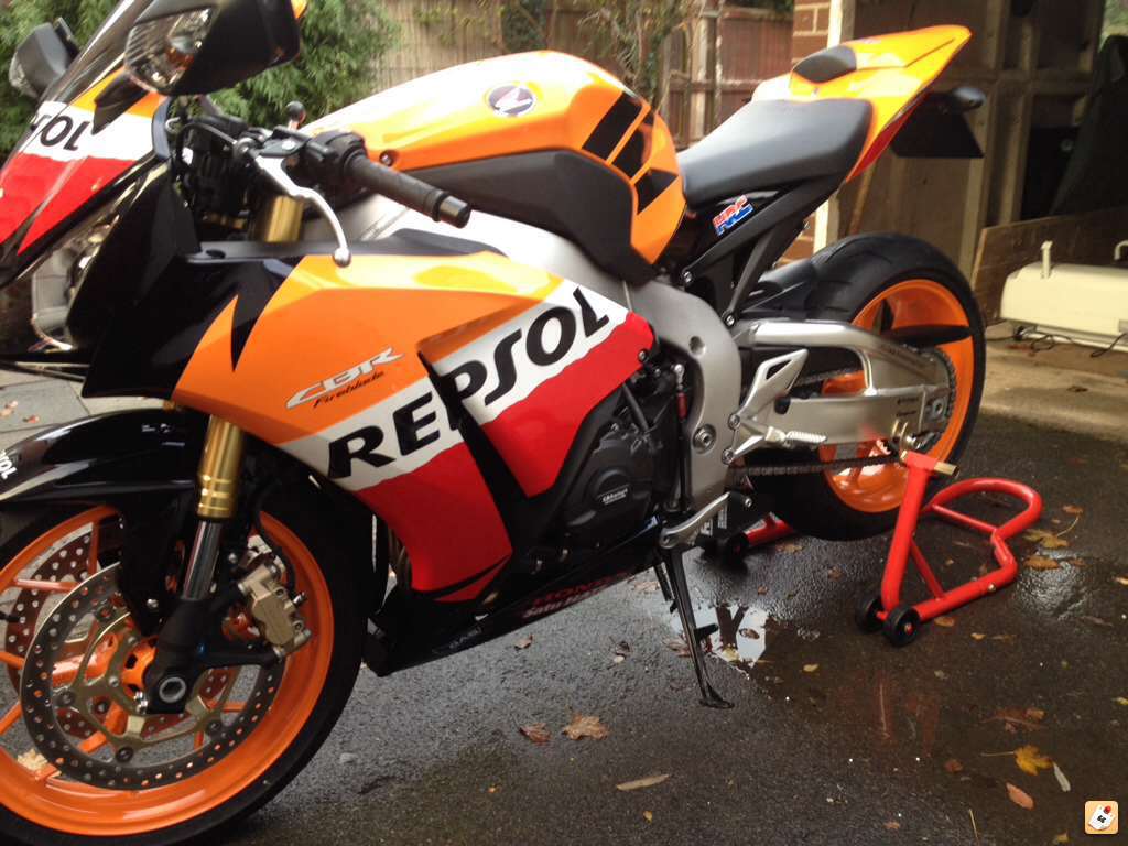

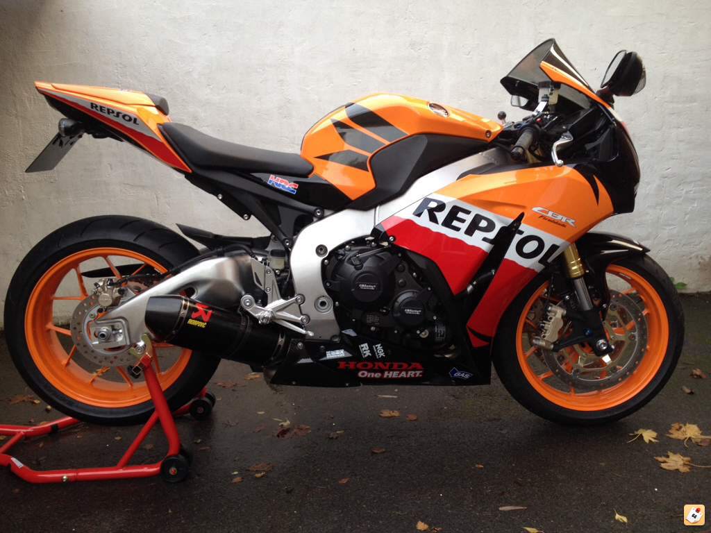

    Spent most of the day fitting the GB racing engine covers (10 mins my arse), HM Plus quickshifter, Akrapovic carbon slip-on and Leo Vince exhaust cover.
    Very happy with the results but the 2012 fairings are even more of a ball ache than the 2010 HRC was and took a while to get to the coils for shifter.
    Anyway done now so a couple of pics :)

  6. Jamiestrada
    Had to shave down the cover as it was fouling against frame so bolt wouldn't line up then the 2012 fairing needs the fairing undoing to allow enough room to fit the other cover ....
    All in all not bad and I ended up with the bike in bits to access the coils as the air tubes are fixed not attached to the fairings like the 08-11 bikes which annoyed me a bit as well....
    All done now exhaust sounds sweet :) ran it up to fan cutting in as Honda suggested to reset ECU and seems ok, just need a dry day now.
