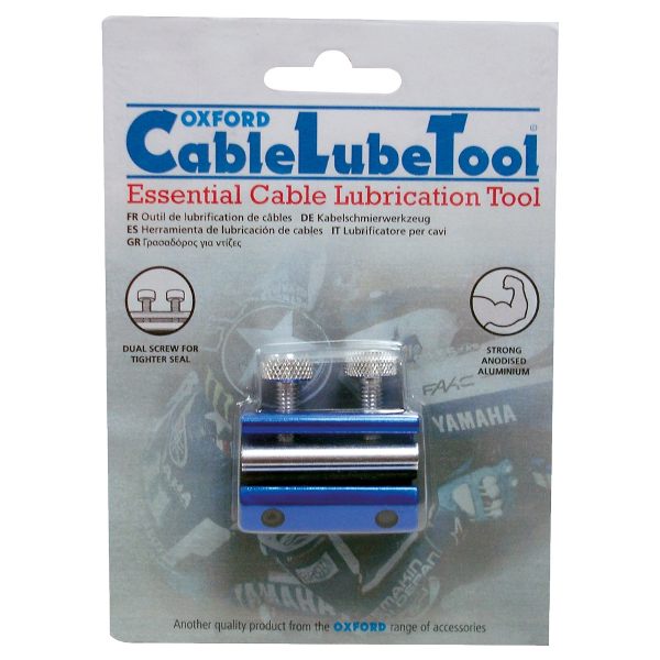

    cable luber has anyone used one and are they any good
    and what lube do you use( can`t believe I asked that;))

    Yep I use one similar to the Oxford tool, works a treat for clutch and choke cables. Use a proper cable lube or something with PTFE which coats the cable. WD-40 is no good for this job.
    Basically keep spraying until you see it coming out the other end of the cable!

    37BF9DFA-64A6-4C75-BACA-EDA31651A150.png Was thinking of this

    Dual screw for tighter seal...mmmhmmm

    What is the mmmhmmm
    Don’t trust what they are saying?
    Had a bad experience?
    Halfords advertise the same thing “duel screw” but there picture only shows a single screw
    Or is this getting dirty:oops:
    It’s early in the morning :confused:

    For the sake of actual technical advise, a "dual screw" is the same type I use. As mentioned, use a PTFE lubricant to avoid actually making the cables worse and simply pump it in until you see it dribble out the other end of the cable.
