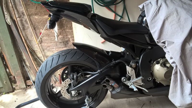

    I chopped a load off the end of a damaged can, opened the side up,drilled out the cat, drilled six 10mm holes inside to allow the bypass and quick exit of exhaust, stuck to pieces of titamium tail pipes, still going to shorten them yet, sounds nice, bike runs very well, all standard.

    A side view would be good.

    Looks interesting....my old man is handy with a welder! As exup says, more pics please

    I am going to shorten the tails as I think they are too long .
    CHop the end off and discard,,remove the overpressure valve and discard.
    Chop a hole in the back and drill,chisel off the CAT , I drilled 6 10mm holes in the exit pipe too then welded a plate back on.

    You could cut the back end off on an angle and have no tail pipe stubbs , just one or two exit holes in the new end plate
