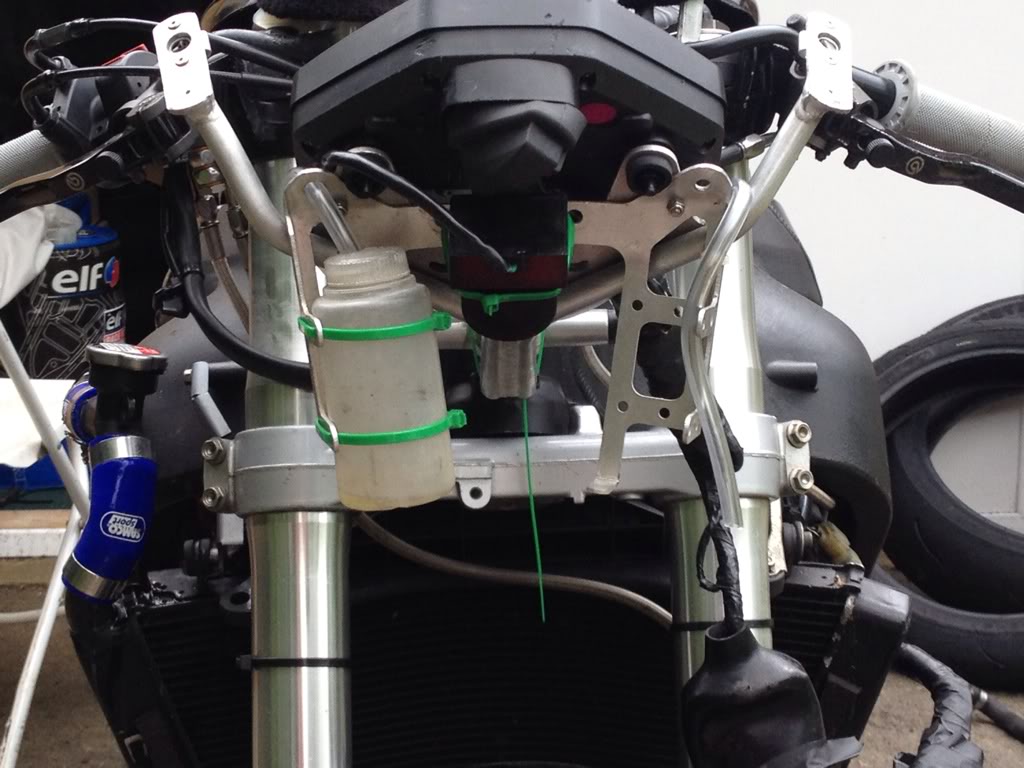

    Yeah plan at the moment anyway is just to use one of these. I see all the wilson craig and padgets bikes use one of these just behing the front fairing
    HRC Parts HRC kit parts CBR600RR HRC parts Overflow bottle

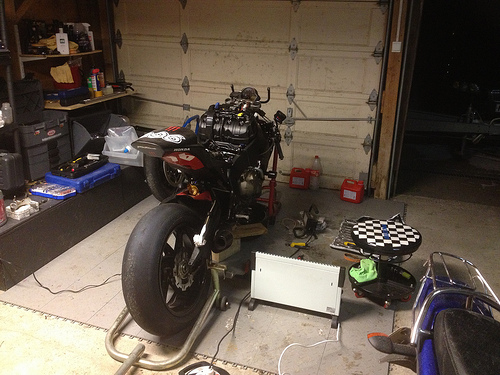

    haven't done much to the bike over the last few months. Living in Norway at the moment and when the temperature in the garage is -15ÂșC on a warm night it doesn't inspire you to go out.
    However today I decided to get stuck back in and have a few pics to update you on my progress

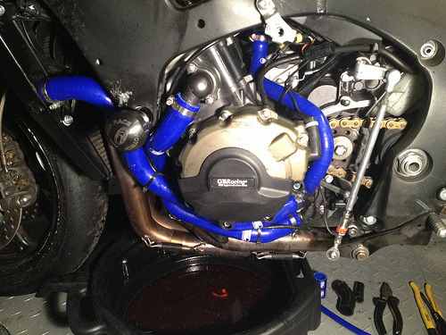

    fitted some samco hoses

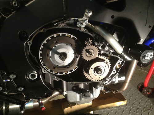

    changed the clutch to the "upgraded" newer one apparently there was a recall on some 08 blade clutches
    Got too cold sitting in the garage at -15. couldn't feel my hands

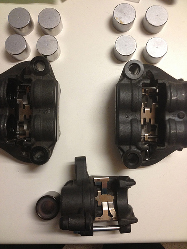

    So moved inside and stripped the brakes to give them a good clean

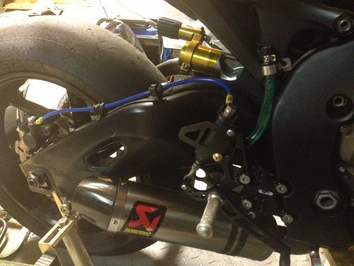

    Still waiting for my forks to come back so haven't really been able to do that much apart from re fit my rear caliper, new brake line and new HRC brake fluid tube.
