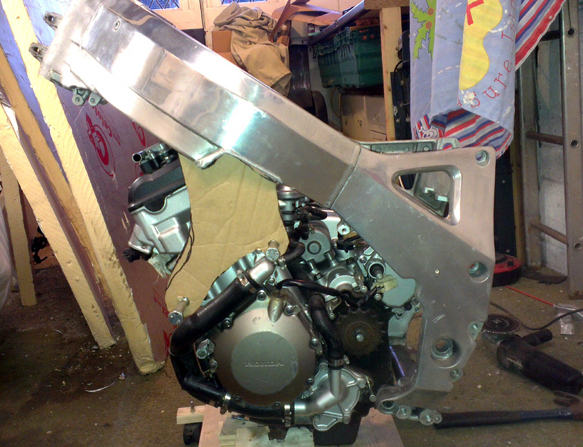

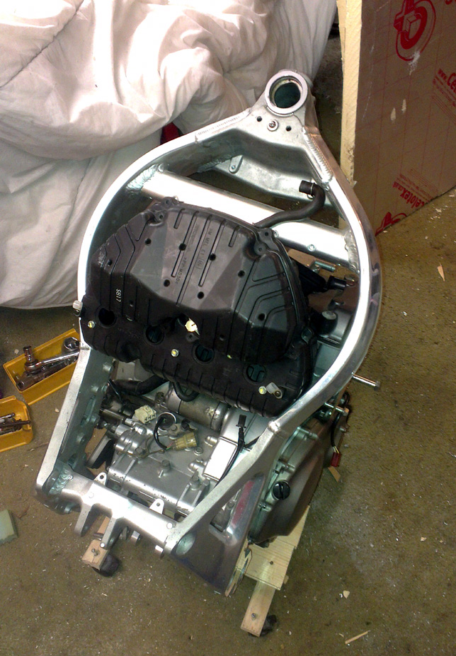

    Well was in the garage for another couple of hours tonight, made up some cardboard front supports and removed all the old mount material from the frame. Bloody messy business all this grinding work had enough of it now! Im not really happy with how these look so will redesign them I think as dont match the frame style. Wont see them when fitted but I guess but needs to be right :)
    left side, ignore the mess building a log cabin also so crap dumped in the garage!
    Right side
    I also tried the airbox on, it fits but the front support beam on the frame could foul the airbox so may have to be lowered.. Next job will be to fit the swinging arm and make sure the chain run is correct before moving on.

  6. martinowen
    9,906
    Ok as said I have no clue what I'm talking about with this stuff so please take this as a question not criticism, will the engine be sat at an angle? And would that cause any issues with oil circulation?
    Reason I ask is I put an m16 engine in a pug 205 once but because we had to have the lump very slightly at an angle to fit it all in the oil didn't reach one side and went bang (oops)

  8. lambchops
    lambchops Elite Member
    Aug 21, 2013
    2,885
    1,606
    Thanks very much for the kind comments guys :) means alot.
    Martin its a good point and I do want to get the engine as level as possible to avoid anything like this but I dont think it quite so critical as a car as bikes dont have the oil serge issue that cars have in the corners, plus they have more oil in the sump as dont have separate gearbox / engine oil like a car.
    Im going to drop the engine in to the frame a tad more I think anyway as its not quite level yet.. The engine is sat up at the front slightly on the stand which makes the angle look worse than it really is. I think if I do this the airbox may clear the beam support also which would be handy. Means adding a cut-out for the cam chain adjuster though so more frame mods.

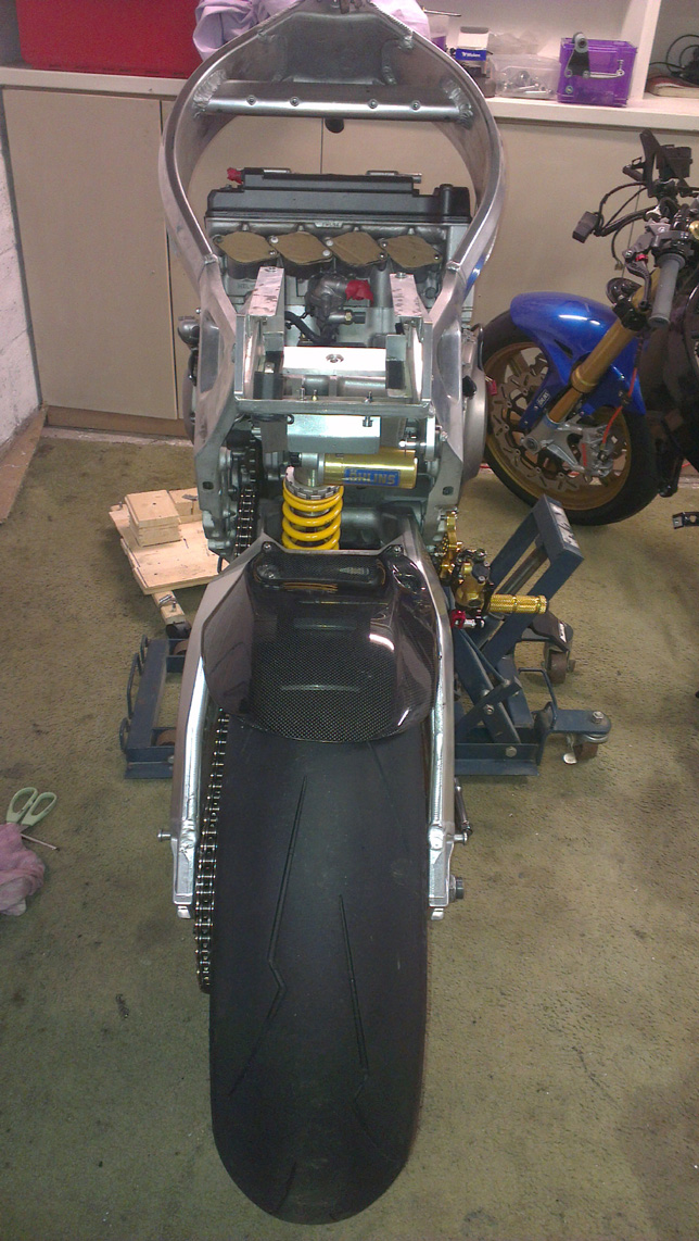

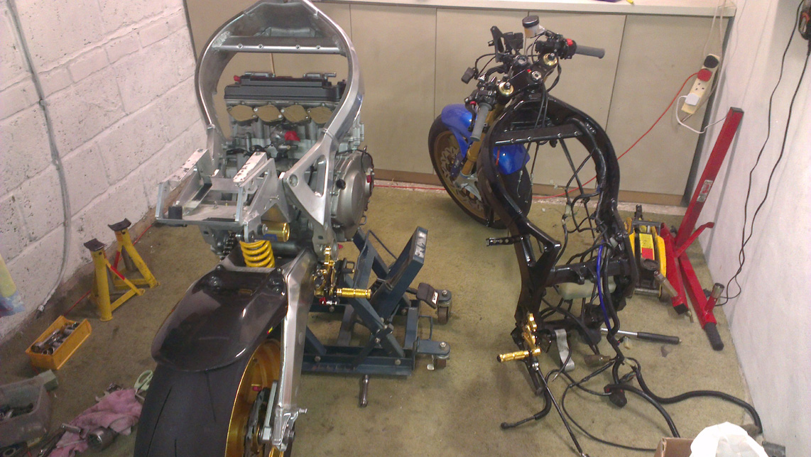

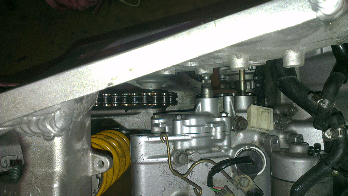

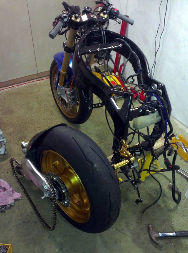

    OK so more miss spent time in the garage this evening playing with bits of motorcycle :)
    Before getting anything welded to the frame I wanted to check the chain run lines up so I removed the swinging arm from the other frame.
    After some jiggery pokery had it mounted to the new frame
    Chain run doesnt look too bad so happy with this :)
    Also fitted the subframe and took some more shots, looks like its getting close!! Shame it isnt :)

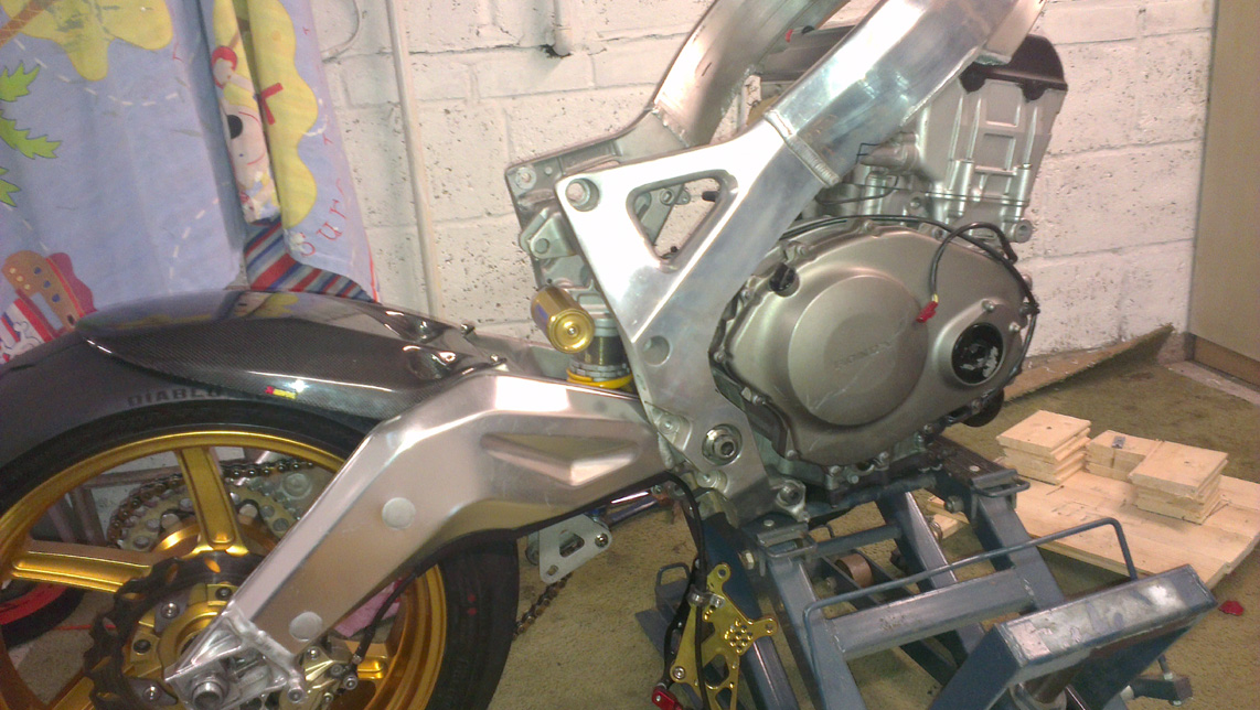

  10. lambchops
    Aug 21, 2013
    2,885
    1,606
    well looks like its realy coming on doesnt it? Ready to ride by next weekend at this rate!! haha
    Tried everything on while the engine was in position to make sure I have clearance for the radiator. Unfortunately looks like a need a new chain as its not going to be long enough :( cost me £120 for that renthal chain at the beginning of the year and now I need another! Oh well
