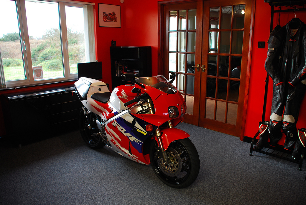

    Time to blow the cobwebs off the winter hibernation.
    Nice 50 mile blat, after a winter of lazy Blade power commuting, I had to recalibrate my brain for 400 riding,
    must keep those revs up, and how these puppies drop into a corner faster than a whore drops her draws.
    Now a complete strip down and refurb before the summer season.
    Not sure whats up with the light metering on my IPhone, these pics are well over exposed.
    One of the last NC30s made, crated from new, never used in Japan, first fired up in the UK in Sep 99, so on a V plate.
    Near full history including original docs and bill of sale and the feeble 35W headlamp bulbs, and all original except race can and screen.
    MPH clocks from new and covered 11k miles so far.
