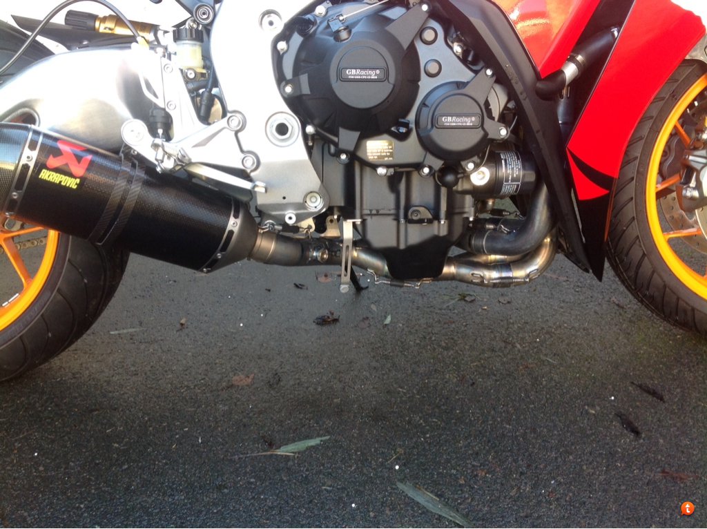

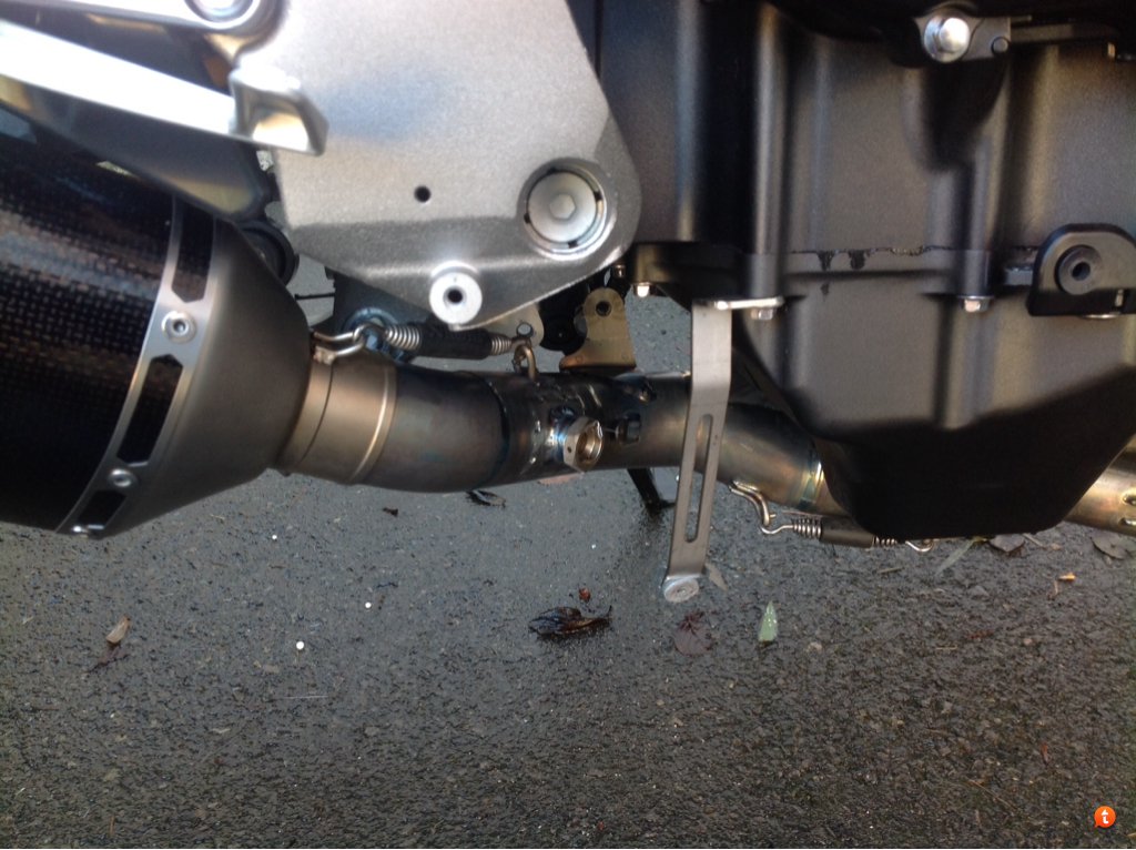

    Just thought if share my experiences trying to fit a race system to a road bike.

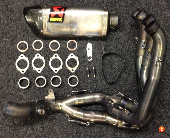

    A few weeks back I got told about a full BSB titanium Akrapovic system which had been removed from Michael Rutters Bathams Honda decided to have a shot at fitting it to my 2013 Repsol...
    My intention was to fit it and sell my Slip on Akrapovic but it soon became apparent when I trial fitted it to the bike that it would take a lot of work to make the titanium end can fit and look half decent, also there is no baffle with the BSB end can which also has a damaged carbon end cap :( so I have had a play and the Carbon end can from the slip on fits perfectly, which while good in a way is annoying in another as I had told a forum member I would sell them the slip on kit and had to let them down (sorry again)

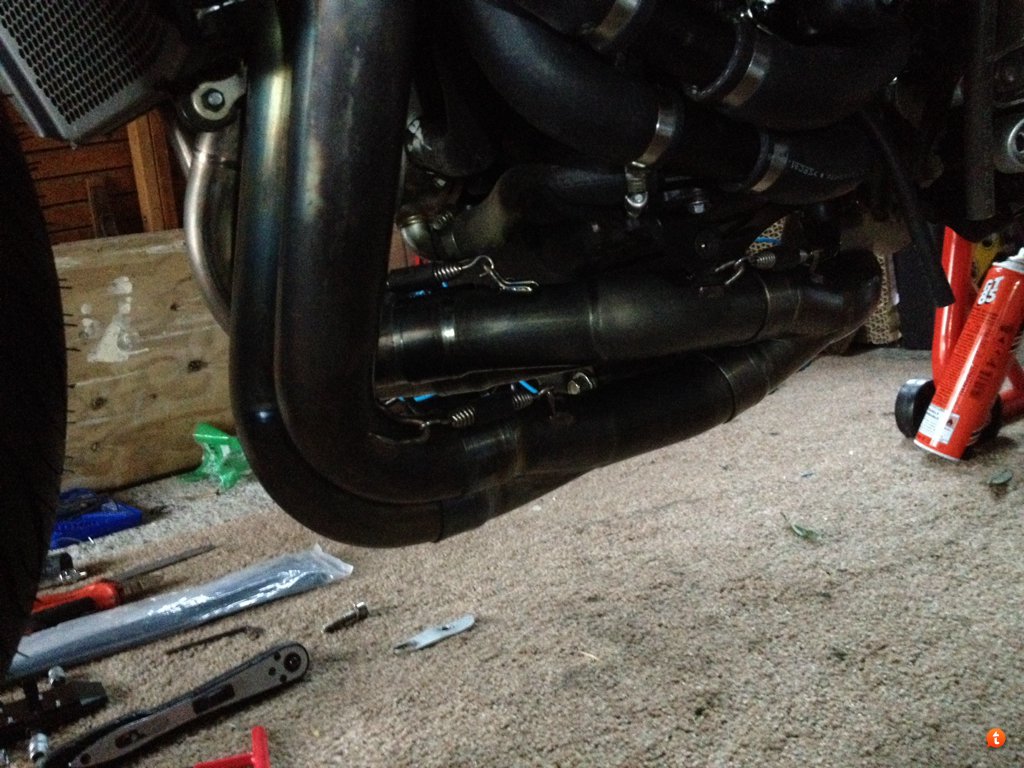

    I had to order 8 long springs to hold on the headers from Jamie at Calsport as they were missing from the kit so finally got around to fitting the system today, it fits perfectly and I'm very happy as the headers are 1 kg lighter than the OE ones as well as looking gorgeous
    [​IMG][​IMG]
    Now the final job is to make the lower fairing fit ! The headers hang down a lot more than the OE headers as you can see, so I have ordered some black lower fairings from mark aka Yorkshiregooner for me to cut an mess with until they fit :) hopefully it shouldn't take a lot of work
    So once all is done ill get off to Somerton Dyno for a custom map, until then I have loaded power commanders euro full akra system map so should be ok
    Started the bike up it sounds ace a much deeper tone than the slip on, will be interesting to see Dyno results once it's all done :)
    Will post some fitted pics up once its all done

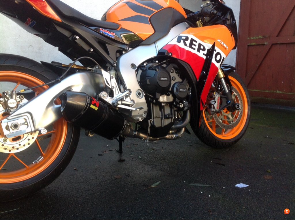

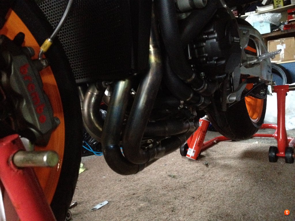

  18. Jamiestrada
    Few pics of the bike as it is now before the lower fairing hopefully goes on and hides all that lush titanium :(
